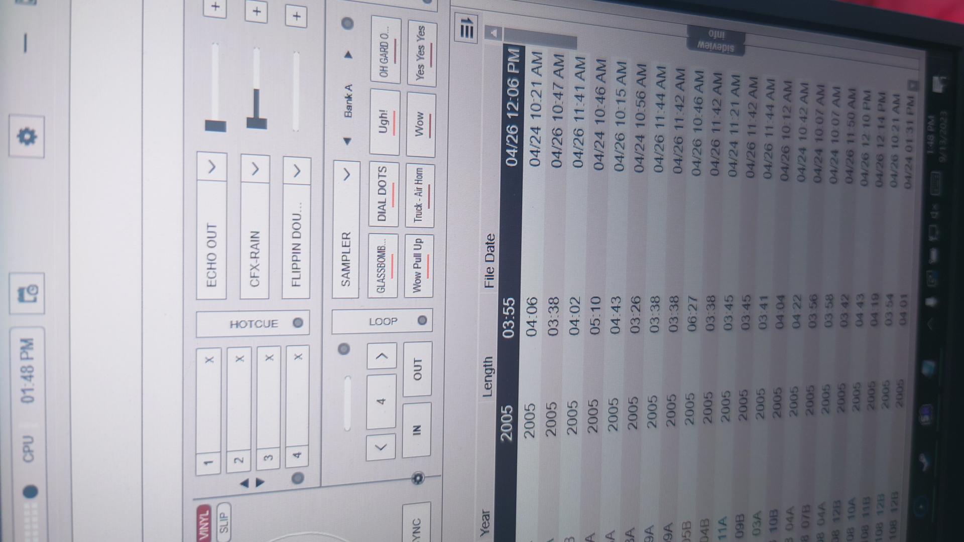

Is it possible for someone to Edit the Performance skin and take out the Pads section in the skin? It used to just show Sampler only and then an update later it wants to show STEMS, SAMPLER, and HOTCUE randomly. So if I can get that removed it would frustrate me less.

Essentially with this last update, that pads section has gone out of wack for me. I have a mixer and a pioneer sound bank as I call it. Essentially it's an add on that replicates the Pads on a controller.
For the longest while, the Pads section was always on Sampler which corresponded to the mixer and the the Pioneer didn't interfere with that at all. Now its constant Chune everytime I use the pioneer for cue points.
So basically speaking, I guess I need that pads section to just reflect the mixer and not the pioneer - if that makes sense

You don't need to edit anything.
You just need to set you pad pages to be independent.
You can either set the pad pages of your subcontroller to be independent from the mappers tab in settings (and so the skin will follow the mixer), OR to set the skin to be completely independent by changing the "padSkinIndependent" setting (and the skin will follow neither mixer or subcontroller)
