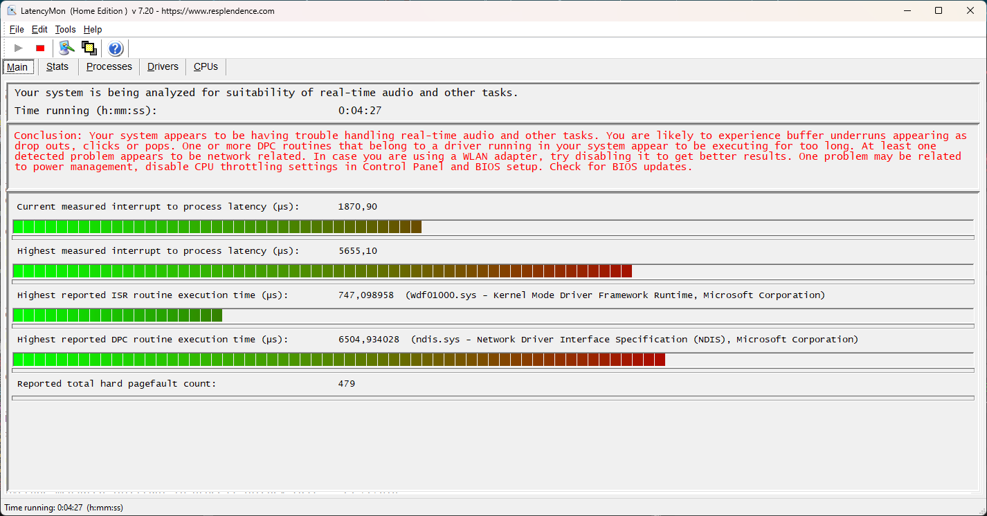

Thanks! I tried 1), 2), 3) and also reverted back to an earlier Windows 11 version.
But then I tried Latency Monitor. As long as no stems are being used, all is "green", but once stems are being used I get this screen:
I think I will go with KLAUS' suggestion to install Windows 10, as it seems to many things in (my) Windows 11 are not ok...
I will keep you posted. Meanwhile, any suggestions may help. Thanks already all of you for the help, I really appreciate this.

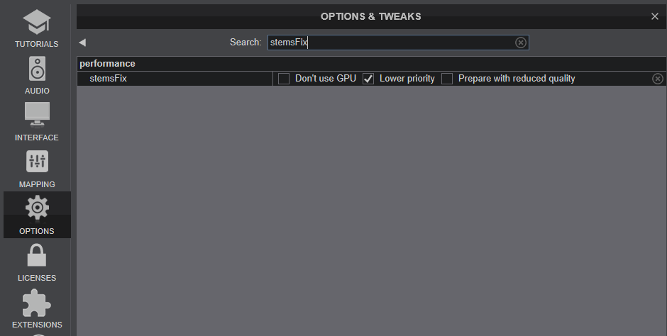

There is a setting to lower the priority on stem creation you might try that first can't remember what it is exactly and I'm away from home
Posted Mon 06 Mar 23 @ 7:16 pm
Thanks... but it used to work flawlessly, so that makes it extra frustrating...
Posted Mon 06 Mar 23 @ 7:33 pm
Latency shouldn't increase when calculating stems. That readout suggests other more deeply rooted issues with your PC.
I did some testing today and neither driver or DPC latency increased at all during stem creation, and that's with Windows 11 home. I also had video out, lighting interface module and MCX8000 connected and a live RDP session to my tablet all going at the same time.
Have you considered it could just be something wrong with your actual machine or just the fact it's a borderline spec for use with stems?

The machine is more than strong enough for Stems, I did gigs for hours using live mashups with Stems 2.0 all the time without any issue at all, at a latency of 512. It is only since 3 ..4 weeks the massive troubles started, so indeed there might be something with the machine, but then the Device Manager does not give any errors.
I am now installing Windows 10, will see if that helps...

I would try setting it this way instead of installing windows 10 way easier
worst thing is it doesn't work and you install windows 10
