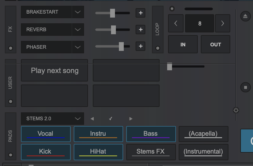

Does anyone know where in the code I can find these lines in order to move them? I found others, but not these perpendicular ones.
Posted Wed 22 Feb 23 @ 8:27 pm
My suggestion would be:- take a screen grab of the skin, then use image editing s/w to determine the x/y co-ordinates of the line(s), then search the XML for those co-ordinates.
Posted Wed 22 Feb 23 @ 8:32 pm
search for left side (Line 2556):
and for right side (Line 3588):
<line x="+10" y="+10+90+10+100+10" width="799-307-10" height="2" color="dark" hightlight="hightlight" shadow="shadow" />
<line x="+306" y="+10+90+10+100+10" width="799-306-10" height="2" color="dark" hightlight="hightlight" shadow="shadow"/>
Posted Wed 22 Feb 23 @ 10:36 pm
It worked, thank you! What about the vertical one?
Posted Wed 22 Feb 23 @ 11:20 pm
3739
3675
<line x="+0" y="+0" width="2" height="233" color="dark" hightlight="hightlight" shadow="shadow" />
3675
<line x="+304" y="+0" width="2" height="233" color="dark" hightlight="hightlight" shadow="shadow" />
Posted Thu 23 Feb 23 @ 7:19 am
It worked! Thank you so much!
Posted Fri 24 Feb 23 @ 3:44 am

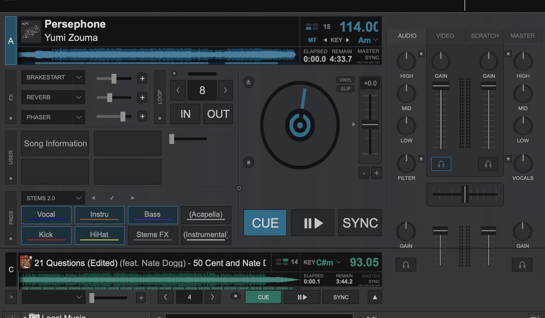

Does anyone know what line has the gray/green background to decks 3 & 4? I can move the elements within, but I need to move the main canvas down covering the buttons for 1 & 2.
Posted Sun 05 Mar 23 @ 1:16 am
check round the MINI DECKS area.
Posted Sun 05 Mar 23 @ 7:57 am
Tried it already, not much luck.
Posted Sun 05 Mar 23 @ 9:29 pm
What are you needing to move?
mini decks are positioned right by
MINI DECKS
the skin divider(s) you'll find line elements as part of
BROWSER
Posted Sun 05 Mar 23 @ 10:20 pm
The big gray/green horizontal gap.
Posted Sun 05 Mar 23 @ 10:37 pm
that doesn't help me, so good luck.
Posted Sun 05 Mar 23 @ 10:43 pm
I figured it out. But now I can't find the waveform for deck 3.
Posted Tue 07 Mar 23 @ 5:47 pm
I'm guessing you didn't change your breakline?
[the part of the skin that resizes to maintain aspect ratio for everything else]
realistically you'd want conditional anyway so remove breakline from the topline of the skin
is the default
you'll want a whole new lines
breakline="675"
is the default
<breaklines breakline1="675" condition="var_equal '@$4decks' 0" />
<breaklines breakline1="ABOUT THE SAME Y AS BROWSER POSITION WHEN 4 DECKS" condition="var_equal '@$4decks' 1" />
Posted Tue 07 Mar 23 @ 6:01 pm

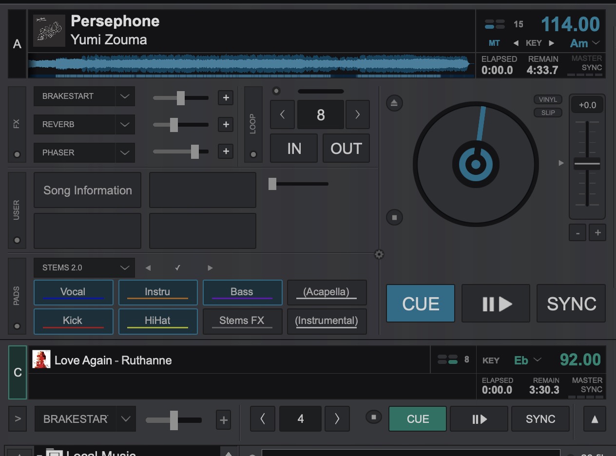

It helped, but it also stretched everything including the knobs and jogwheel.
Posted Tue 07 Mar 23 @ 7:12 pm
show code you used.
Posted Tue 07 Mar 23 @ 7:28 pm
