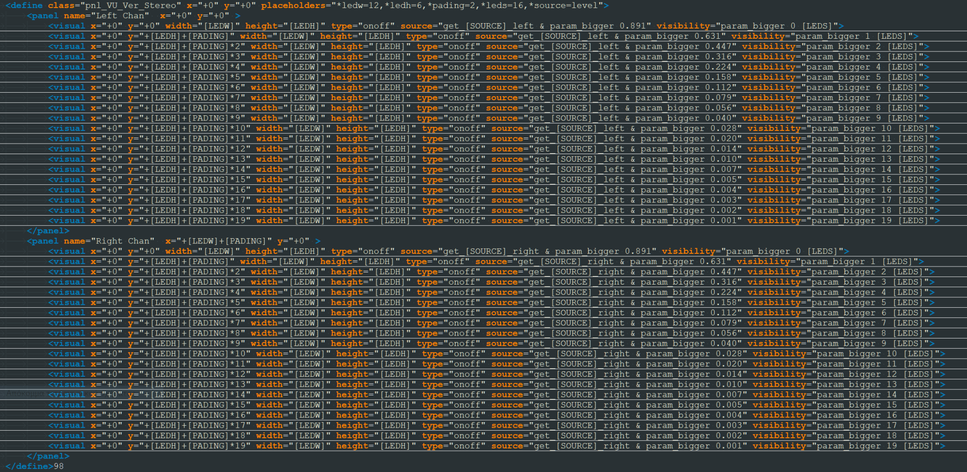

Since you started with VU meters.. this is part of my new upcoming skin.
I also have it defined for "Stereo"
<define class="pnl_VU_Ver_Mono" x="+0" y="+0" placeholders="*ledw=12,*ledh=6,*pading=2,*leds=16,*source=level">
<panel name="Single Column" x="+0" y="+0" >
<visual x="+0" y="+0" width="[LEDW]" height="[LEDH]" type="onoff" source="get_[SOURCE] & param_bigger 0.891" visibility="param_bigger 0 [LEDS]">
<off color="col_vu_deck_off"/>
<on color="col_vu_deck_warn"/>
</visual>
<visual x="+0" y="+[LEDH]+[PADING]" width="[LEDW]" height="[LEDH]" type="onoff" source="get_[SOURCE] & param_bigger 0.631" visibility="param_bigger 1 [LEDS]">
<on color="col_vu_deck_hr"/>
</visual>
<visual x="+0" y="+[LEDH]+[PADING]*2" width="[LEDW]" height="[LEDH]" type="onoff" source="get_[SOURCE] & param_bigger 0.447" visibility="param_bigger 2 [LEDS]">
</visual>
<visual x="+0" y="+[LEDH]+[PADING]*3" width="[LEDW]" height="[LEDH]" type="onoff" source="get_[SOURCE] & param_bigger 0.316" visibility="param_bigger 3 [LEDS]">
</visual>
<visual x="+0" y="+[LEDH]+[PADING]*4" width="[LEDW]" height="[LEDH]" type="onoff" source="get_[SOURCE] & param_bigger 0.224" visibility="param_bigger 4 [LEDS]">
</visual>
<visual x="+0" y="+[LEDH]+[PADING]*5" width="[LEDW]" height="[LEDH]" type="onoff" source="get_[SOURCE] & param_bigger 0.158" visibility="param_bigger 5 [LEDS]">
<on color="col_vu_deck_on"/>
</visual>
<visual x="+0" y="+[LEDH]+[PADING]*6" width="[LEDW]" height="[LEDH]" type="onoff" source="get_[SOURCE] & param_bigger 0.112" visibility="param_bigger 6 [LEDS]">
</visual>
<visual x="+0" y="+[LEDH]+[PADING]*7" width="[LEDW]" height="[LEDH]" type="onoff" source="get_[SOURCE] & param_bigger 0.079" visibility="param_bigger 7 [LEDS]">
</visual>
<visual x="+0" y="+[LEDH]+[PADING]*8" width="[LEDW]" height="[LEDH]" type="onoff" source="get_[SOURCE] & param_bigger 0.056" visibility="param_bigger 8 [LEDS]">
</visual>
<visual x="+0" y="+[LEDH]+[PADING]*9" width="[LEDW]" height="[LEDH]" type="onoff" source="get_[SOURCE] & param_bigger 0.040" visibility="param_bigger 9 [LEDS]">
</visual>
<visual x="+0" y="+[LEDH]+[PADING]*10" width="[LEDW]" height="[LEDH]" type="onoff" source="get_[SOURCE] & param_bigger 0.028" visibility="param_bigger 10 [LEDS]">
</visual>
<visual x="+0" y="+[LEDH]+[PADING]*11" width="[LEDW]" height="[LEDH]" type="onoff" source="get_[SOURCE] & param_bigger 0.020" visibility="param_bigger 11 [LEDS]">
</visual>
<visual x="+0" y="+[LEDH]+[PADING]*12" width="[LEDW]" height="[LEDH]" type="onoff" source="get_[SOURCE] & param_bigger 0.014" visibility="param_bigger 12 [LEDS]">
</visual>
<visual x="+0" y="+[LEDH]+[PADING]*13" width="[LEDW]" height="[LEDH]" type="onoff" source="get_[SOURCE] & param_bigger 0.010" visibility="param_bigger 13 [LEDS]">
</visual>
<visual x="+0" y="+[LEDH]+[PADING]*14" width="[LEDW]" height="[LEDH]" type="onoff" source="get_[SOURCE] & param_bigger 0.007" visibility="param_bigger 14 [LEDS]">
</visual>
<visual x="+0" y="+[LEDH]+[PADING]*15" width="[LEDW]" height="[LEDH]" type="onoff" source="get_[SOURCE] & param_bigger 0.005" visibility="param_bigger 15 [LEDS]">
</visual>
<visual x="+0" y="+[LEDH]+[PADING]*16" width="[LEDW]" height="[LEDH]" type="onoff" source="get_[SOURCE] & param_bigger 0.004" visibility="param_bigger 16 [LEDS]">
</visual>
<visual x="+0" y="+[LEDH]+[PADING]*17" width="[LEDW]" height="[LEDH]" type="onoff" source="get_[SOURCE] & param_bigger 0.003" visibility="param_bigger 17 [LEDS]">
</visual>
<visual x="+0" y="+[LEDH]+[PADING]*18" width="[LEDW]" height="[LEDH]" type="onoff" source="get_[SOURCE] & param_bigger 0.002" visibility="param_bigger 18 [LEDS]">
</visual>
<visual x="+0" y="+[LEDH]+[PADING]*19" width="[LEDW]" height="[LEDH]" type="onoff" source="get_[SOURCE] & param_bigger 0.001" visibility="param_bigger 19 [LEDS]">
</visual>
</panel>
</define>
Posted Sat 25 Feb 23 @ 3:17 am
