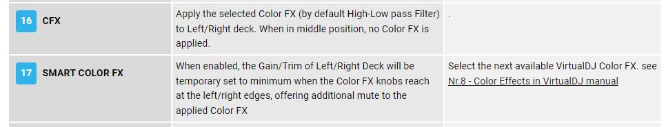

DJ Alibi HTX wrote :
...are you guys planning to add anything to the Smart CFX or button?
That is also already added
Both a regular function and a SHIFT function
From the manual:
Posted Mon 20 Feb 23 @ 6:38 am

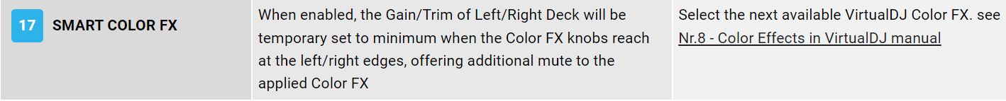

How is smart color fx supposed to work in virtual dj? What is the logic of work. In ddj flx4 it's like 2 effects at the same time, like filter and echo. What about virtual dj? Can I see a video of the work somewhere? And another question, smart fader does not work, just like in ddj flx4. In rekordbox it works on both crossfader and fader, but in virtual dj it only works on crossfader? Will full functionality be implemented?
Posted Thu 02 Mar 23 @ 6:27 am
You can see exactly what it does in the VDJ FLX4 manual:
The right column is the shift+ function
