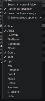

3. The ctrl+f in serato is used for find, but in Serato it goes to the top of all your crates and searches your entire collection. In VDJ, it just searches the folder you are currently in.

Yes, VDJ wil search what you tell it to in the little dot menu next to the search field:
