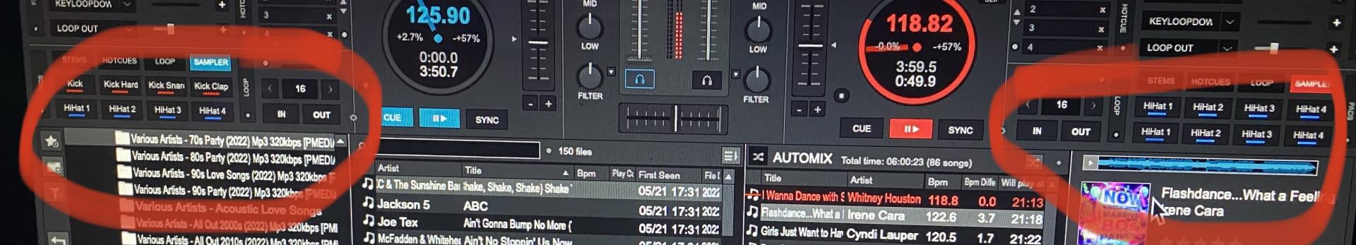

Hi there, I’m a paid user of vdj. Recently I’ve noticed that the small pads in the bottom right of deck 2 are showing hi hate 1/2/3/4 then underneath showing the same samples.
Deck 1 is showing kicks underneath.
How do I get my kicks back under the deck please?

Added a picture for explanation
Posted Sat 29 Oct 22 @ 8:18 pm

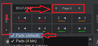

Hi,
toggle the Pad View to default and change the Padpage.

Thanks Danny,, found it. It’s set to default.
Posted Sat 29 Oct 22 @ 8:28 pm

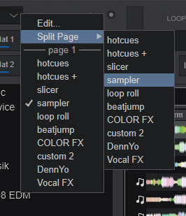

look here. I think you have activate Split Page with a second Sampler.
With SplitPage you can the bottom 4 Pads change to Pad 1-4 from an other PadePage.

You can’t have two samplers selected. I’m at a gig at the moment so can’t reset. Very frustrating though as I use the kicks to beef up slower songs. I’ll just muddle through and reinstall tomorrow
Posted Sat 29 Oct 22 @ 8:51 pm
