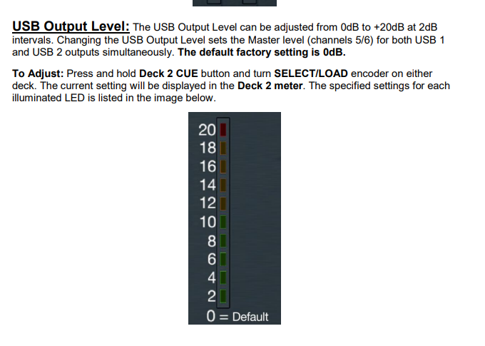

HO UN DENON DJ 7000 QUANDO VADO IN REGISTRAZINE IL VOLUME E' MOLTO BASSO , NON TROVO COME AUMENTARE I DB, AIUTO!!!
Posted Sat 22 Oct 22 @ 3:00 pm

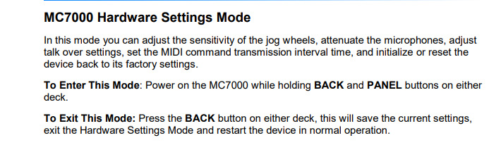

Note: If the level of the recording is low, you could increase that from the device Settings Mode. See USB Output Level section at
http://cdn.inmusicbrands.com/denondj/MC7000/MC7000-Hardware-Settings-Mode-Specification-v1_4.pdf
This file is part of the current firmware (included in the firmware zip file), but be changed in the future, so always check the content of the firmware zip file.

ma non ho giĆ risposto a questa domanda?
puoi cambiare il livello di registrazione usb
