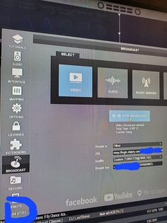

Same issue here. I tried to 2 different servers on both my laptops i updated and they both shut down. I tried use my cellphone to connect to same server and it works. I tried cell phone on wifi network the laptops are on and it connects. Yeah something happened after update.
Posted Sat 15 Oct 22 @ 12:30 am
could the bug be with a custom rtmp?
Posted Sat 15 Oct 22 @ 12:38 am
Posted Sat 15 Oct 22 @ 12:39 am
user24671917 wrote :
thanks i got it...
i had issues using a custom rtmp, so went back to b7151 and mines connects now as showm
