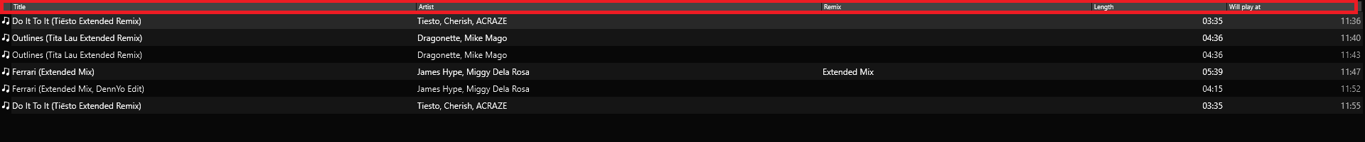

when i use the Custom Browser Element <filelist source="sidelist"> there is no Index on the Top? I think it's a Bug.

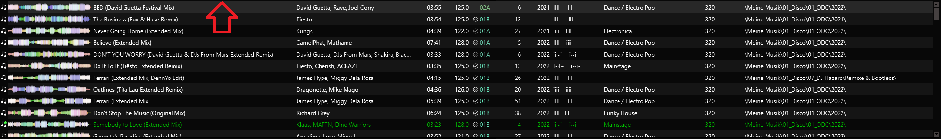

On <filelist source="automix"> is the Index visible.
SIDELIST:
AUTOMIX:

It's because the sidelist as a separate list is by default used below the main list.
Will add so that you can force it by adding headerheight="1" in the next update.
