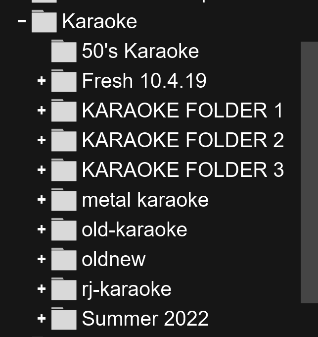

I've used VirtualDJ for a fairly long time and, in the past, have had no trouble scanning (add to DB) the "karaoke" folder on my hard drive or on an external drive. I've tried to migrate to an external SSD and am having to browse the drive before each search. My understanding is...
r-click on Karaoke ->point to Batch->click on "Add to Search DB"
...should add all sub-folders of the Karaoke folder. I've also "removed from.." and added again. the browser window is empty as all my media is in subfolders. When i execute a search, no results come up. If I...
r-click on Karaoke->Click on Recurse->r-click on Karaoke->point to Batch->click on "Add to Search DB"
... a very fast file count happens. Here's the thing, when i execute a search, the interface shows a browsing file count before displaying results. Here's another thing, I have another folder called "Music" and, if i select it and do the same routine, when i go back to Karaoke, i have to repeat the process.
I did find a suggestion on the VirtualDJ support site for checking r/w permissions; however, the external drive is formatted in extFAT. What am i doing wrong?
Posted Tue 20 Sep 22 @ 1:57 am
