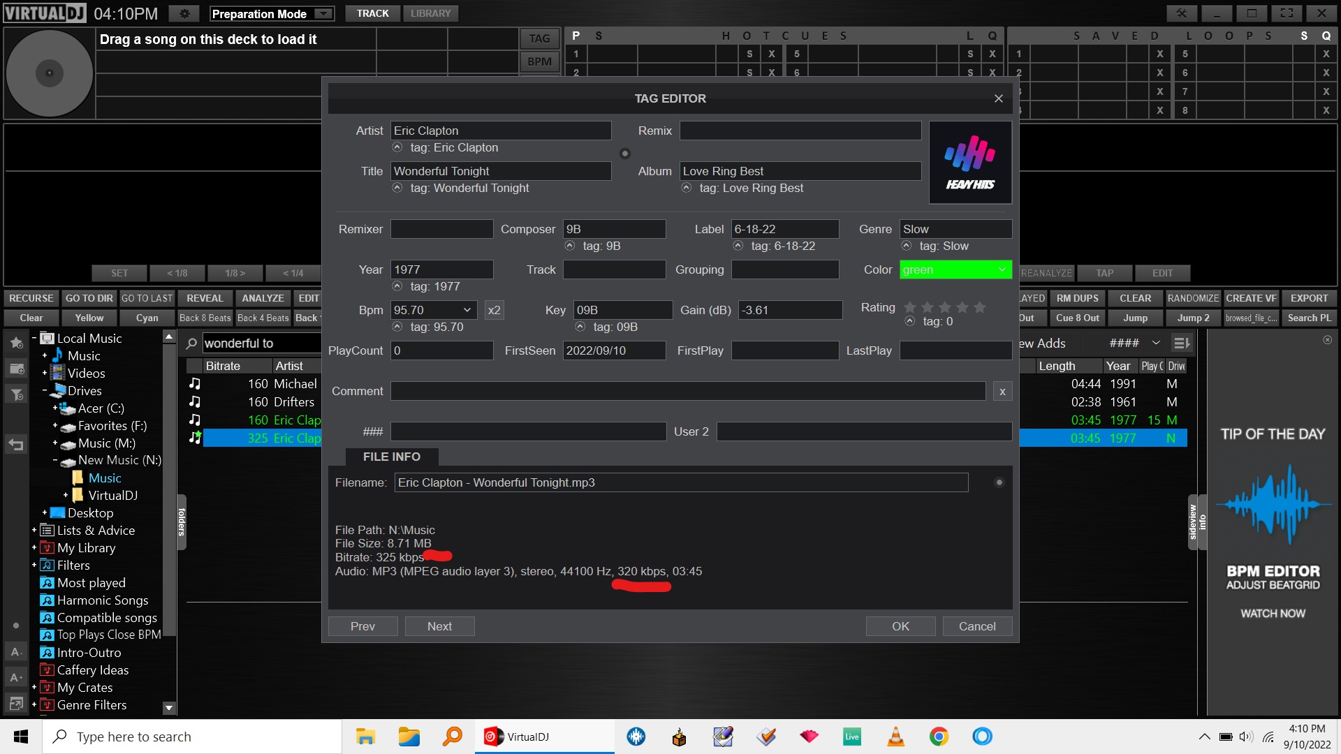

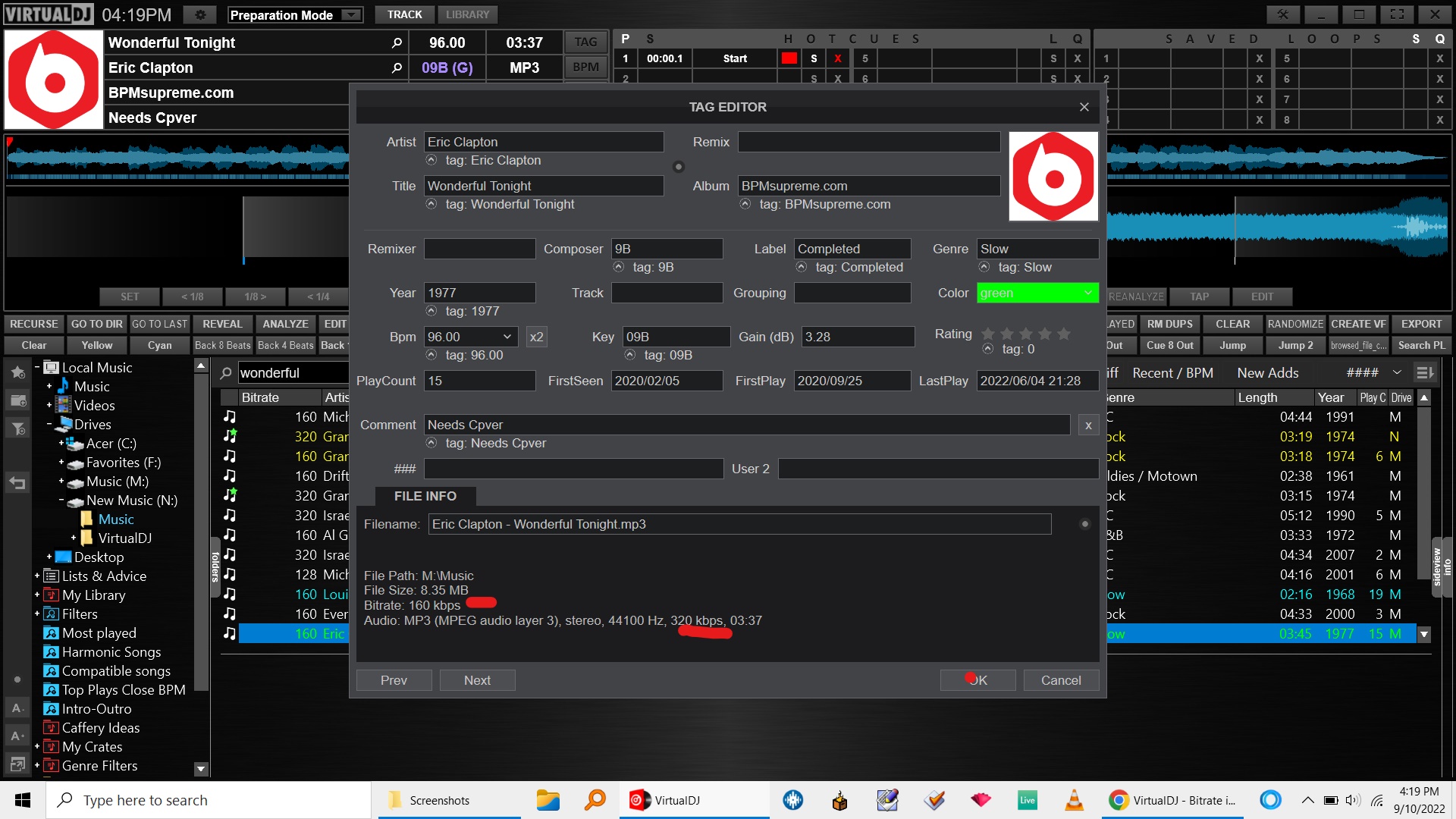

I've been updating my older lower bitrate files to at least 320kbps. If i have a file that has the exact same name I choose to replace the file and it seems to work. All other tag info moves to the new file but in VDJ the bitrate is still incorrect. see picture. The files is 320 kbps
 MU.jpg)
 MU.jpg)
Thanks
Joe
 MU.jpg)
 MU.jpg)
Thanks
Joe

you need to reanalyze the files for VDJ to update the bitrate. Probably wise to do anyway so VDJ can cerate new automix points and analyze the gain.
Posted Sun 11 Sep 22 @ 12:04 am
Thank You. That was it I never knew that
