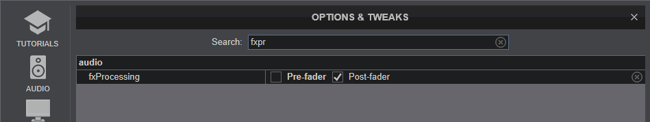

Yes, if VDJ is handling the mixing there is (if the audio config is set to use external mixer, then this physical mixer will of course turn down everything- nothing VDJ can do about that)
Anyway, it's called post-fader fx so try looking up fx-processing in the VDJ settings

For post-fader Effects, you need to set fxProcessing setting to Post-fader

Changing the fx processing option to post fader has worked a treat. Last question, what settings should are recommended for the echo effect in terms of beat, frequency etc...
