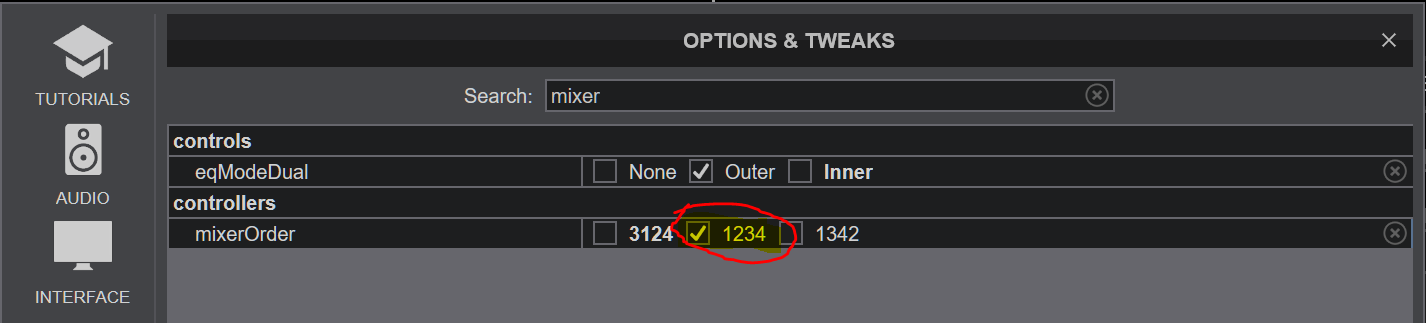

As I said you need to set the correct mixerorder in VirtualDJ.
Open VirtualDJ settings and then click on options icon on the left.
On the top there's a search box
Type in mixerorder
Choose the 1234 option.
Close settings
Use decks 3 & 4 (C & D) on VirtualDJ to perform (since decks 1&2 are the leftmost sliders in this case that are occupied by the line inputs)
Type in mixerorder
Close settings
