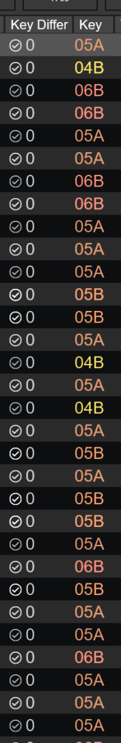

I am trying to set filters in the browser and I am struggling to understand the Key difference filter.
The only thing that is clear is if I set Key difference = 0, I get (let's take a hypothetical example of a playing song in the key 05B):

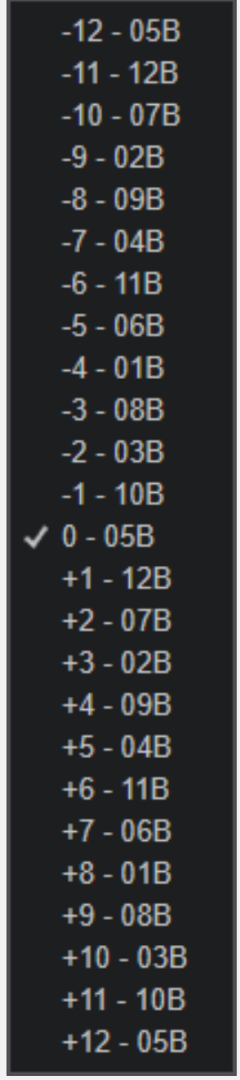

I wanted to add additional keys to be highlighted by different colours. If I use Key difference = 1, I get (for the above 05B example) 09B, 10A, 10B, 12A, 11B and 12B.
I thought that likely we are not moving on the Camelot wheel, but on the musical scale (as the screenshot proposes):
which makes sense.
The questions (all are related to the above 05B example):
Which value for Key difference shall I use to achieve the above? Thanks.
- Same key: 05B
- All notes are identical, just relative scale: 05A
- Six of seven notes are identical: 04B and 06B
which makes sense.
- How to highlight only one key, not all the compatible keys as well? If I wanted to highlight exactly one key, i.e. only 05B songs?
- How to move in only one direction, i.e. to highlight +2 = 07B but not -2 = 03B?
- How to move from inner to outer or from outer to inner cycle, i.e. to highlight 06A with a different colour?

keyDiff of 0 indeed shows all compatible keys as well, so for 5B, it shows 5B, 4B, 6B and 5A
keyDiff of 1 shows all songs which can be made compatible by only moving the key up or down by 1 semi-tone.
In your example, 09B = G Maj can be increased by one semitone to reach Ab Maj = 04B
Posted Wed 20 Apr 22 @ 4:53 pm

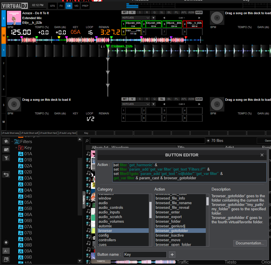

I just made a filter for all 24 possibilities,
press button, query track key, go to filter
Posted Fri 22 Apr 22 @ 4:46 am
Can you demonstrate, please?
Posted Fri 22 Apr 22 @ 5:03 am
make your 24 filters in the root of the filters folder filter name them as the harmonic you filter for "10B" etc
button
button
set filter `get_harmonic` &
set filter `param_add 'get_var filter' 'get_text "Filters://"'` &
set filter01goto `param_add 'get_text ".vdjfolder"' 'get_var filter'` &
get_var filter & param_cast & browser_gotofolder
Posted Fri 22 Apr 22 @ 5:45 am
Hey, that is smart. I understand it as clicking on the custom button the browser would open the filter folder with the same name as the key of the loaded song. That would be amazing.
I already had the folders (I was browsing them manually), but the button does not work for some reason. Something happens (I see some unfolding and folding of the folders), but the browser keeps showing the same folder I was in before clicking on the button.
What am I doing wrong? Would you advise, please, how to list a folder in a subfolder Key (in Filters)?
Posted Fri 22 Apr 22 @ 12:15 pm
because your filters aren't on the root of filters they're in a vFolder, let me fix the script
Posted Fri 22 Apr 22 @ 12:54 pm
If you're not using the root of filters for your keys [like maybe in a virtual folder on the root of filters, vfolder called called "key"]
set gotoString `param_add "get_text '\Folders\Filters\Key.subfolders\'" get_vdj_folder"` &
set gotoString `param_add "get_harmonic" "get_var gotoString"` &
set gotoString `param_add "get_text '.vdjfolder'" "get_var gotoString"` &
get_var gotoString & param_cast & browser_gotofolder
Posted Fri 22 Apr 22 @ 1:18 pm
Works like a charm. Thanks a lot.
Now the biggest challenge is going to be to find a button on my controllers to map this custom button :)
Posted Fri 22 Apr 22 @ 2:18 pm
