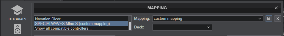

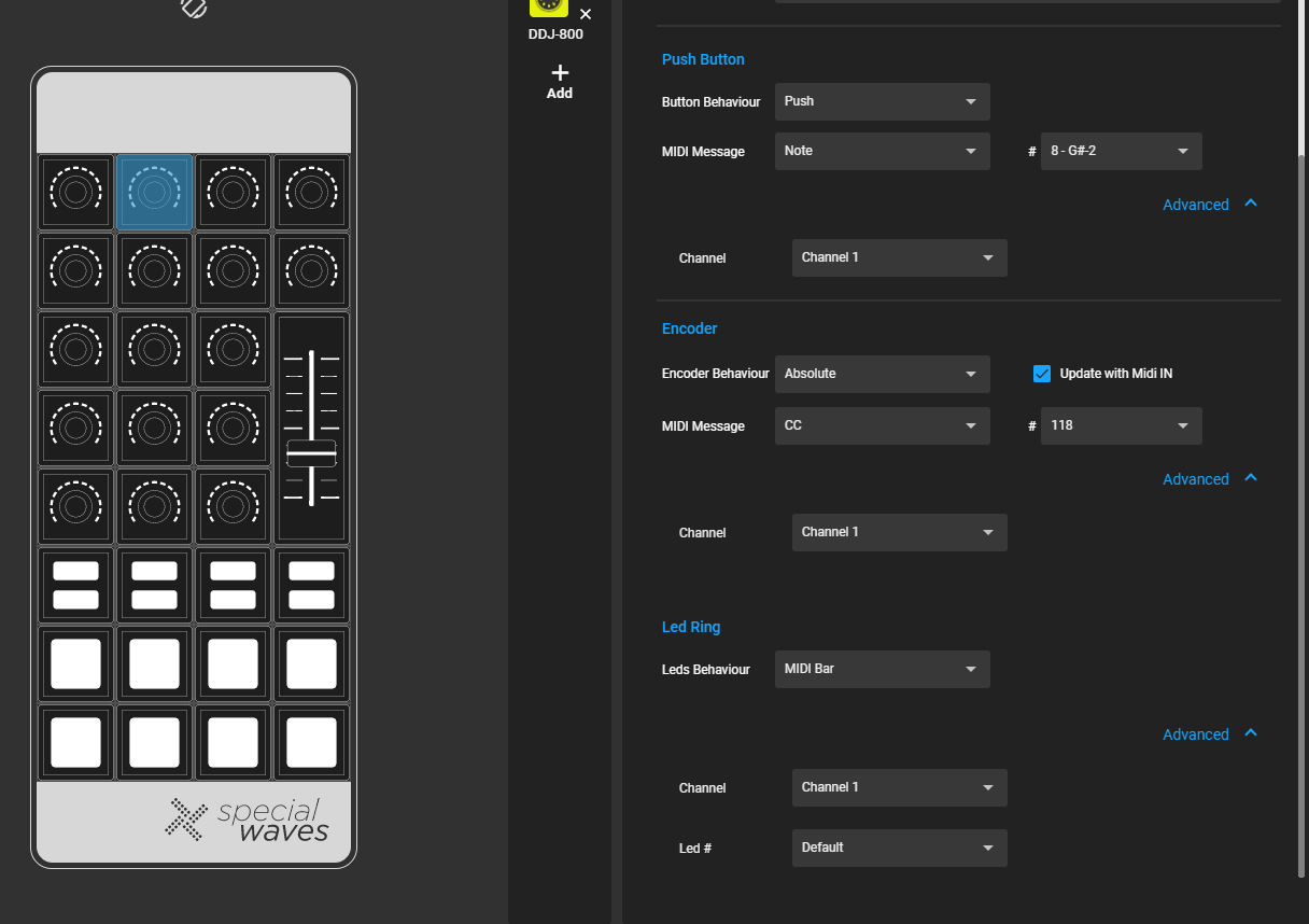

I have the Special-waves Mine-S controller with encoders. I can assign any midi note on the controller in their MineApp Configuration app:

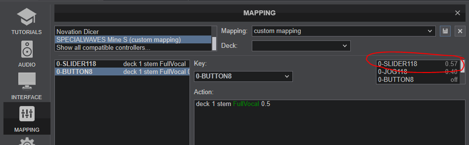

When I connect the controller configured in this way to VDJ, I see the name of the controller.
When I turn an encoder or press a button, I already get names for each slider/button etc.
Therefore I believe the XML Definition File for the MIDI controller is included inside VDJ already - correct?
Now my question: I want to use the encoders for stems. I am able to map them, but I would like the encoders to immediately pick up the value that has been set/updated in Virtual DJ (i.e. when changing it with the mouse or when some of "Fullxxx" stems, such as FullVocal, also mute other stems).
I have read this thread: https://virtualdj.com/forums/244530/VirtualDJ_Technical_Support/Live_update_encoder_value_on_midi_fighter_twister.html
I believe the XML is built in to VDJ, but I even tried to define new XML (to overwrite the built-in, or simply in case I am wrong and no built-in definition exists), but I am not able to create the file, as I do not know how to find out the below values and which of them are mandatory:

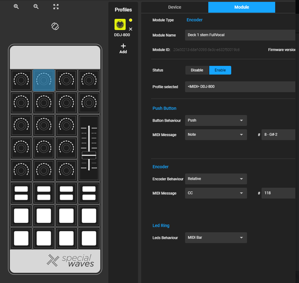

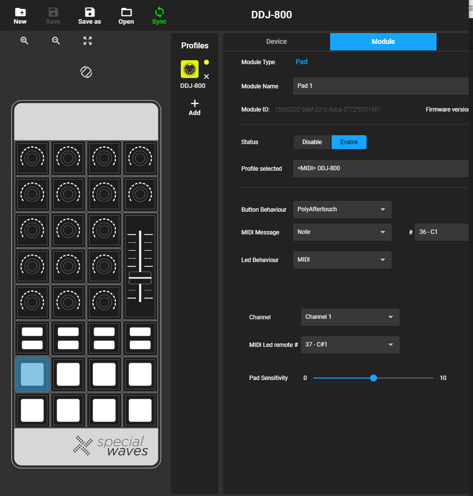

And attached are MIDI configurations of these elements from MineApp
Posted Fri 08 Apr 22 @ 2:02 pm

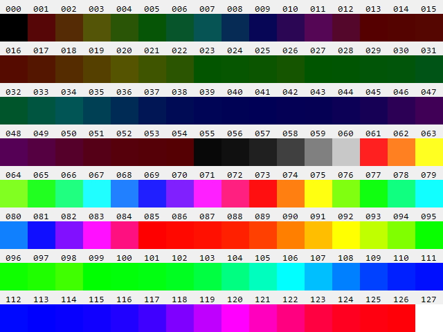

They have just sent me the palette.
Posted Fri 08 Apr 22 @ 4:04 pm
Yes, the table was probably some example i gave them from a different controller, and definitely they dont follow any RGB pattern.
Use this ..
Remember, put the table="" above only in your first <color>, then the rest should only have values="table"
Use this ..
table="0x00=#000000,0x01=#560607,0x02=#552B05,0x03=#545507,0x04=#2A5506,0x05=#065506,0x06=#07552B,0x07=#065454,0x08=#062B55,0x09=#070656,0x0A=#2B0654,0x0B=#550655,0x0C=#54072B,0x0D=#550000,0x0E=#540300,0x0F=#550601,0x10=#550B00,0x11=#541600,0x12=#552C00,0x13=#554000,0x14=#555401,0x15=#3F5500,0x16=#2B5501,0x17=#035500,0x18=#065601,0x19=#0B5500,0x1A=#155500,0x1B=#005500,0x1C=#005502,0x1D=#015507,0x1E=#01550A,0x1F=#005516,0x20=#00552B,0x21=#005540,0x22=#015555,0x23=#004054,0x24=#002B55,0x25=#011655,0x26=#000B55,0x27=#000556,0x28=#000255,0x29=#000056,0x2A=#040055,0x2B=#050054,0x2C=#0C0056,0x2D=#160055,0x2E=#2C0055,0x2F=#400056,0x30=#550055,0x31=#550041,0x32=#55002A,0x33=#550017,0x34=#56000B,0x35=#550007,0x36=#550003,0x37=#080808,0x38=#101010,0x39=#202020,0x3A=#404040,0x3B=#808080,0x3C=#C8C8C8,0x3D=#FF2020,0x3E=#FF8021,0x3F=#FFFF21,0x40=#81FF21,0x41=#21FF20,0x42=#20FF80,0x43=#20FEFF,0x44=#2180FF,0x45=#201FFF,0x46=#8020FE,0x47=#FE20FF,0x48=#FF2080,0x49=#FF0F10,0x4A=#FF7F11,0x4B=#FFFF11,0x4C=#80FF10,0x4D=#10FF10,0x4E=#10FF80,0x4F=#11FFFF,0x50=#1080FE,0x51=#100FFF,0x52=#8110FF,0x53=#FF10FF,0x54=#FE1080,0x55=#FE0000,0x56=#FF0800,0x57=#FF1001,0x58=#FF2000,0x59=#FF4001,0x5A=#FF7F00,0x5B=#FFBE00,0x5C=#FFFF01,0x5D=#C0FF00,0x5E=#80FF00,0x5F=#08FF00,0x60=#0FFF00,0x61=#1FFF00,0x62=#40FF00,0x63=#00FF01,0x64=#01FF09,0x65=#01FF11,0x66=#00FE21,0x67=#00FF41,0x68=#00FE81,0x69=#00FEBE,0x6A=#01FFFF,0x6B=#00BFFE,0x6C=#0080FF,0x6D=#0041FF,0x6E=#0020FF,0x6F=#000FFE,0x70=#0008FF,0x71=#0000FE,0x72=#0700FE,0x73=#1000FF,0x74=#2001FF,0x75=#3F00FF,0x76=#7F00FF,0x77=#BF00FE,0x78=#FF00FE,0x79=#FF00BE,0x7A=#FF0080,0x7B=#FF0141,0x7C=#FF0020,0x7D=#FF0010,0x7E=#FF0008,0x7F=#FFFFFF"

With the HW setting of LEDs, 7 or 8 clicks was always one more LED. If I did a mapping of the encoder LED via VDJ, it was anything between 6 and 14. With relative mapping, it is spot on, I just had to move the LED strip by 0.5 to get the middle LED on on 50%. As a result, the first LED is on on 0% (which is something I wanted).
If you want 1st led to be on when 0%, you could add something like min="0x10" (or some other value that turns the 1st led on)
One other way is to add the values you want in the <bar> like the example below ..
<bar cc="0x75" values="0x00,0x01,0x15,0x2A,0x40,0x55,0x70,0x7F" name="LED_ENCODER_01" channel="0"/>
The values are just an example, you can check with MIDIOX what you need to send for each led to be turned on.

In the end, it works best when I define the encoder LEDs in the XML as
<bar cc="0x77" channel="0" name="LED_ENCODER_11" sendstatic="true" min="0x05" />
The middle LED is on exclusively when I am on 50%, the first LED is on when I am on 0%... Thanks for the hint.
