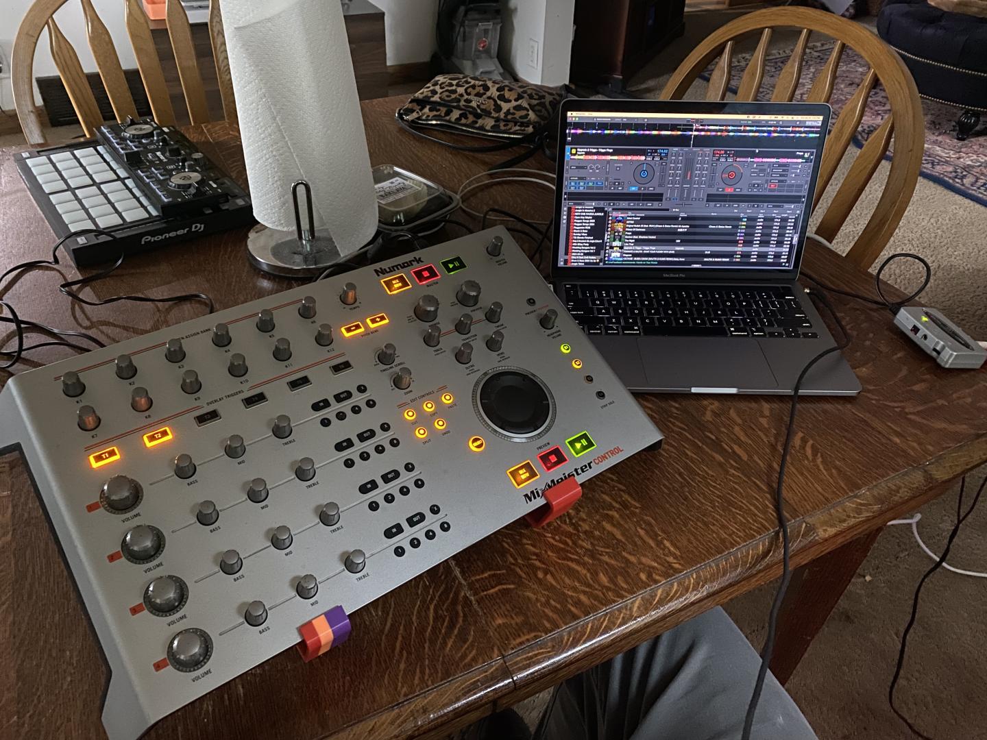

I know no one cares 😝 but it does work 100%
3D printed a stand for it and have been messing around mixing with since I got it up and running.
A few of the mappings need changed or I’m not understanding what they mean (sampler buttons) but other than that it’s all good.
For the soundcard I’m just using an old Behringer U-Control UCA202 for the master out and then I just use my laptop/headphone out for the monitor/pfl.
Posted Mon 29 Jul 24 @ 2:34 am

The layout seems to come pretty natural for me, once I figured out where everything was, I was good to go. Ive switched the EQs to Stems and it really does make mixing with this unit a breeze.
Idk, I know its old as shit but it works better then my MixTrack Edge I think. Less layers to deal with.
