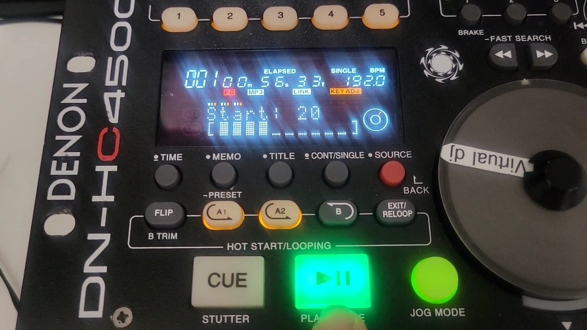

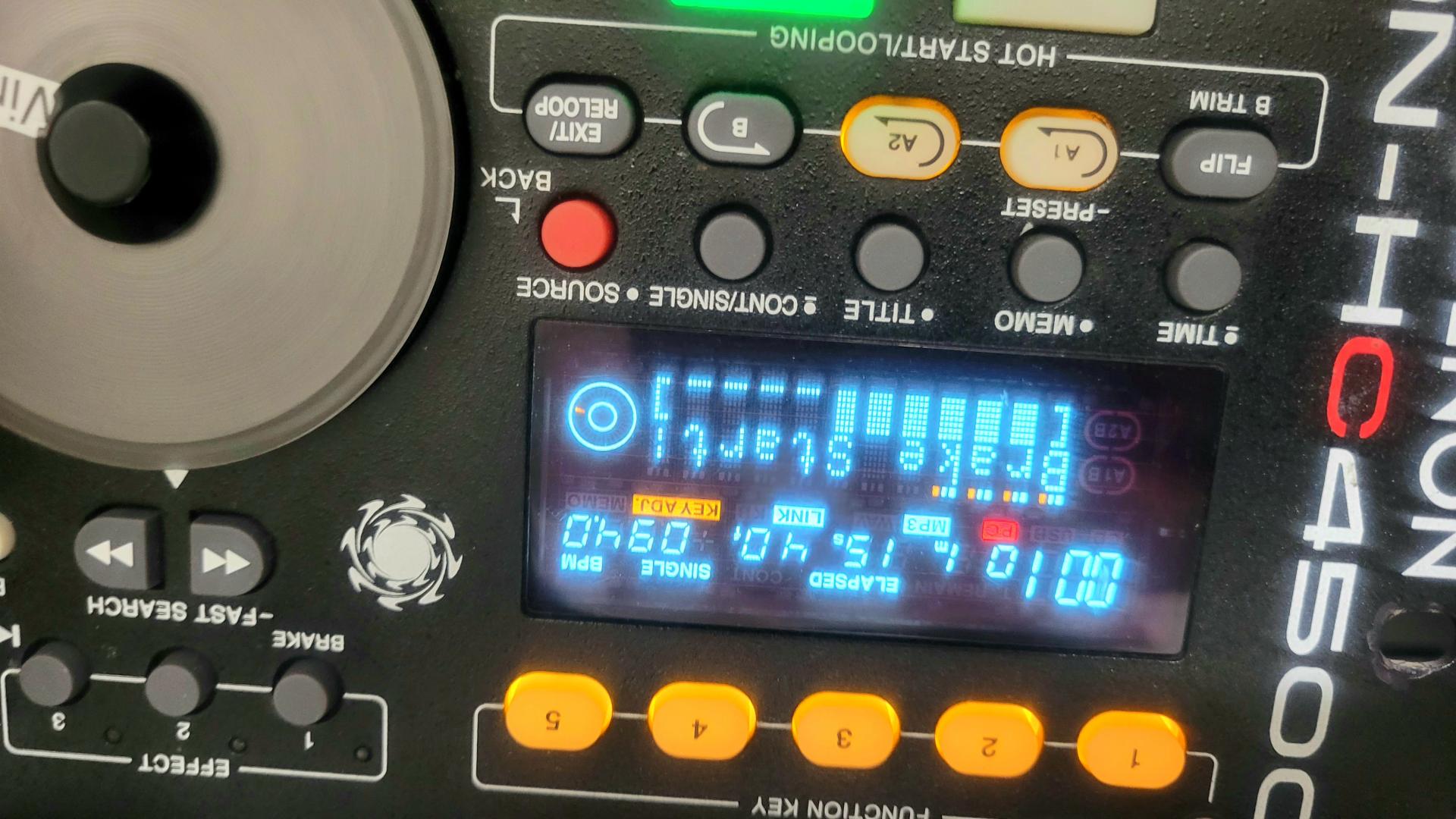

What I'm trying to do is get the start speed value from 0 to 0.25.
I am working on my mapper for the HC-4500 controller.
I will like it to be displayed on the screen, gradually increasing the speed of the startup speed build in virtual dj software
I know you are expert on harware divices
jeje! weird why my pic is uploaded upside down!
thanks again. For your help

OK let me explain a bit better
what I need is to find the position of the startup speed while it is in operation
my idea it displayed on my DN-HC-4500 screen while the startupspeed is in progress
similar how (loop_position) or (sampler_position) work.
but in this case I need for startupspeed.
Thank you
Thank you
