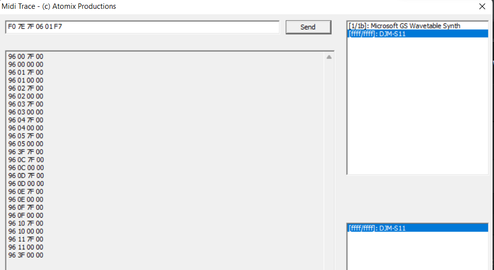

I want to assign some functions to PioneerDJ DJM-S11 Hardware FX keys when pressed with SHIFT, doublick, holding. but these functions are not available in the Default map, I would be very grateful if you could add them. Below I share the MIDI Hex codes and pictures of these keys pressed with SHIFT
Thanks,
DJ Koray
Midi-Trace Hardvare FX keys
96 00 7F 00
96 00 00 00
96 01 7F 00
96 01 00 00
96 02 7F 00
96 02 00 00
96 03 7F 00
96 03 00 00
96 04 7F 00
96 04 00 00
96 05 7F 00
96 05 00 00
96 3F 7F 00
96 0C 7F 00
96 0C 00 00
96 0D 7F 00
96 0D 00 00
96 0E 7F 00
96 0E 00 00
96 0F 7F 00
96 0F 00 00
96 10 7F 00
96 10 00 00
96 11 7F 00
96 11 00 00
96 3F 00 00

Hello ,
Can you add these non exist functions to Build in Definition PionerDJ DJM S11 Device. I tested it work fine
thanks
<device name="DJM-S11" vid="0x2B73" pid="0x0037" author="DJ Koray" description="Pioneer DJM-S11"
version="800" type="MIDI" padColumns="4" padRows="2" padSides="2" decks="">
<audio vid="0x2B73" pid="0x0037"
description="Pioneer DJM11 AUDIO " input="10" output="14" mixer="yes" mic="yes" asio="DJM-S11 ASIO" identifier="#vid_2b73&pid_0037&mi_04#"/>
<button note="0x00" name="HARDWARE_FX1" channel="6" deck="1"/>
<button note="1x00" name="HARDWARE_FX2" channel="6" deck="1"/>
<button note="2x00" name="HARDWARE_FX3" channel="6" deck="1"/>
<button note="3x00" name="HARDWARE_FX4" channel="6" deck="1"/>
<button note="4x00" name="HARDWARE_FX5" channel="6" deck="1"/>
<button note="5x00" name="HARDWARE_FX6" channel="6" deck="1"/>
<button note="0x0C" name="SHIFT_HARDWARE_FX1" channel="6" deck="1"/>
<button note="0x0D" name="SHIFT_HARDWARE_FX2" channel="6" deck="1"/>
<button note="0x0E" name="SHIFT_HARDWARE_FX3" channel="6" deck="1"/>
<button note="0x0F" name="SHIFT_HARDWARE_FX4" channel="6" deck="1"/>
<button note="0x10" name="SHIFT_HARDWARE_FX5" channel="6" deck="1"/>
<button note="0x11" name="SHIFT_HARDWARE_FX6" channel="6" deck="1"/>
</device>

They will be added in the next update.
