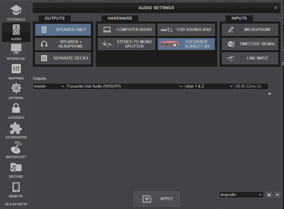

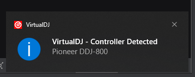

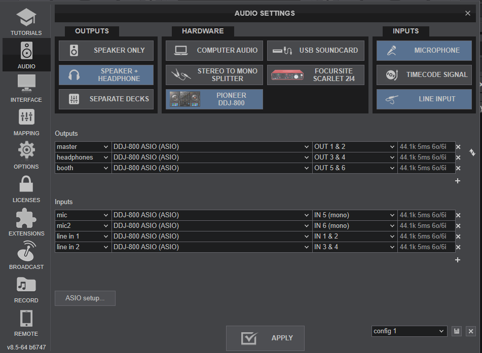

Can you post a screenshot of the Audio setup that you manually set, and another one showing what VDJ auto applies ?
Posted Tue 11 Jan 22 @ 9:38 pm
First image shows the proper setting (DDJ-800 is not powered on at this point), second shows what happens when DDJ-800 is powered on, and third shows what I see if I close VDJ and reopen with DDJ-800 powered on.

I should add that despite the config name showing differently after powering on the controller, switching to the other config does nothing. It still shows all of the same inputs and outputs.
