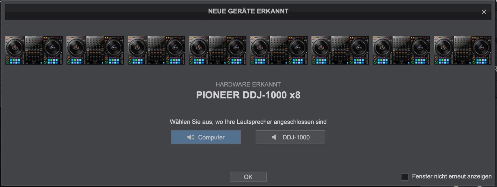

Help! My Pioneer DDJ-1000 Controller is suddenly recognized as 8 devices.
What can I Do?? I have already deleted the mappers and settings file but it always comes back when I connect it...

I'm on a Mac Pro with Big Sur and this causes massive problems when I try to play back and work with the DDJ-1000.
Rekordbox 5 and 6 are working fine with my controller though.

Okay, I solved it myself. My IAC Midi driver was the problem. I created a few ports for another device (StreamDeck) and Virtual DJ got trouble with these additional ports and created kind of a "Midi feedback loop" with the DDJ-1000. This led to VDJ thinking I had multiple devices.
