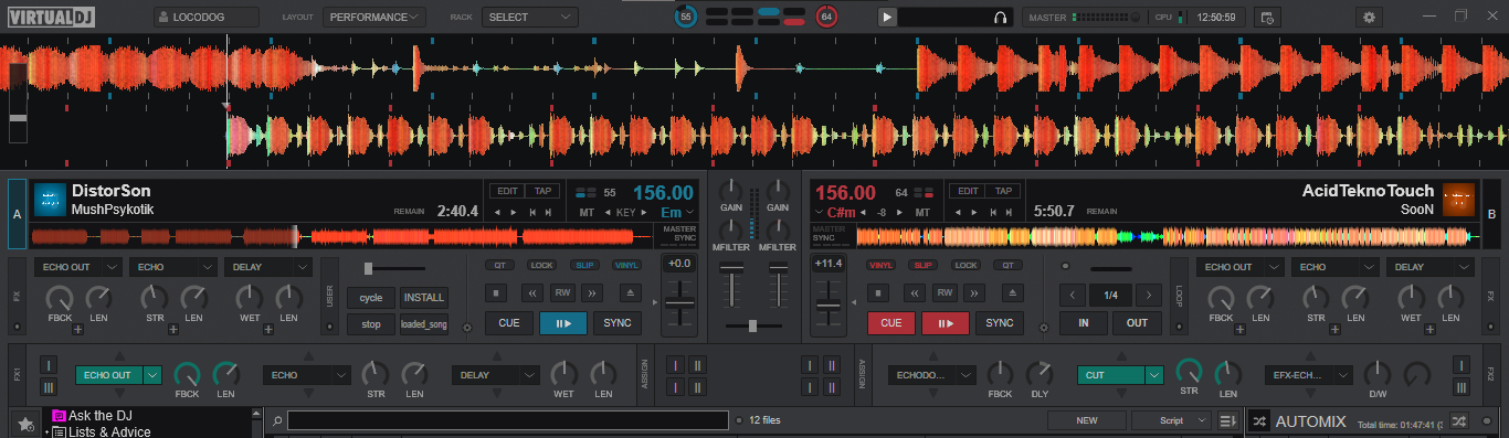

As I said before it can be done, but it's no small task, not one I'd recommend to somebody just starting to learn script.
It would involve editing the performance skin fx rack to keep things visually making sense.
rack would be deck 5 all 6 slots, an rsi watching what was on these slots to change what is on decks 1 - 4 if it was changed by effect_select
fx1 button, on, would look which of the 1st 3 slots were active on deck 5 and switch them on the calling deck
off would just turn slots off the calling deck.
fx2 same but slots 4,5,6
remapping the device would be the simple bit.

It's more complex than even that.
I've approached the full problem [with skin edit too] as I imagined the design, it's running, it has a charm in it's simplicity but that comes at a cost of limitations that I'm not a fan of.
there are issues that are not possible to resolve.
1 you can only have one instance of a native, you can't have [let's say] echo assigned to both 'modules' system would fall apart
2 invisible deck 5 is the 'holder' for fx until assign 1 or 2 is pressed, so auto off fx like slipbrake8 the only way they can work is assign a module to decks then call the fx on with the rack deck 5, invisible decks needs its own careful script to avoid loading/playing a deck by accident you can't access easily.
for a certain workflow it's functional
as I said, the rack is deck 5, all other decks effect selects are linked to deck 5, slots 1,2,3 left module, 4,5,6 right module
