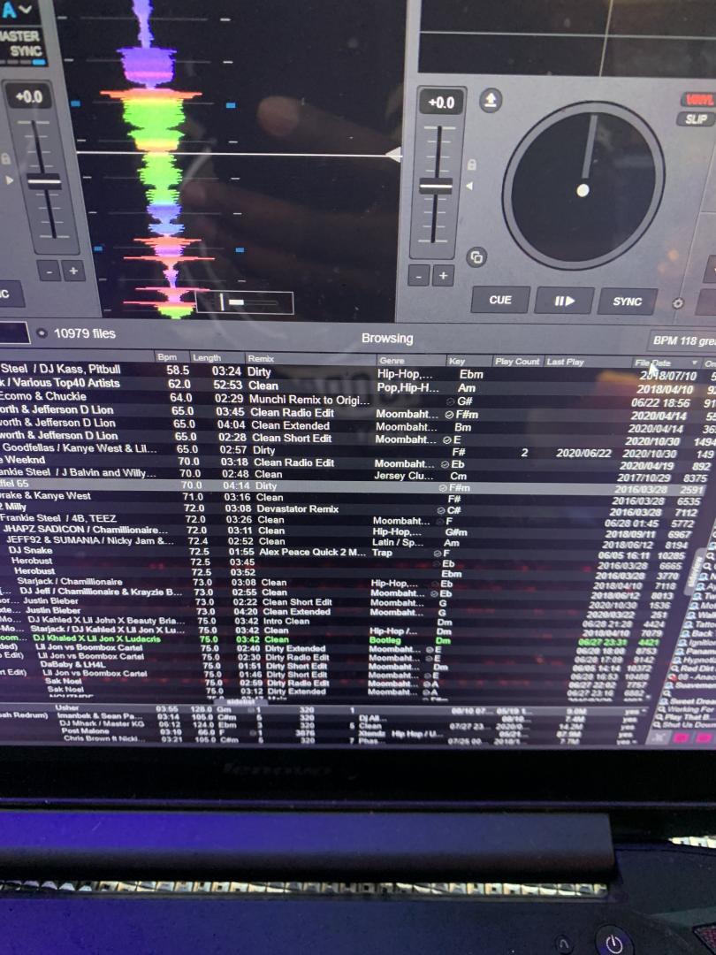

Played with the new version, opened up a few folders, opened up deezer folders… played for a few minutes and try to find a song, it’s then stuck on browsing , I now cannot search for a song, cannot open up any unopened folders. The deck spins fine, I can play songs that is already in the sidelist. Played for like 20 minutes and browsing doesn’t go away…. Cannot search for anything. Downgraded and everything worked fine after…..

Thanks for the tip. I’ll run some test to see if I can replicate what happened with using that field. I’ll then remove it. I’ll be a bit more confident if I know exactly what caused the prob.
While the browsing is there, no search can happen, no vdj crates will open up.

You can also try Early Access build 6604 ( https://virtualdj.com/download/build.html )
We have found a possible cause for the Browsing issue that is fixed in this build.
It is not likely that the file date column was the problem, although it could indeed make browsing a little bit slower.

I decided to update and now after a few minutes I get the circle of death. Music still plays but I am unable to open folders and faders don’t move, as in the display itself has frozen. Did a force quit, restarted my machine and after about 20 minutes, it happened again.

Adion, I used the early release at my last gig. I went nearly 50 minutes in and then it happened again, but it was different thus time. It lasted for 5 minutes the first time, then about 2 minutes. After that a few more times but lasted a couple seconds. Lucky I had tracks in my side list that kept me going while not able to browse. After a couple hours it stopped occuring for the rest of the night, strange. I'll be downgrading for tomorrow's gig.

If it resolves after a minute then it's likely not the same bug.
If it does happen again, you can check the tooltip of the 'browsing' status message to get more detail on which folder it is stuck on.
