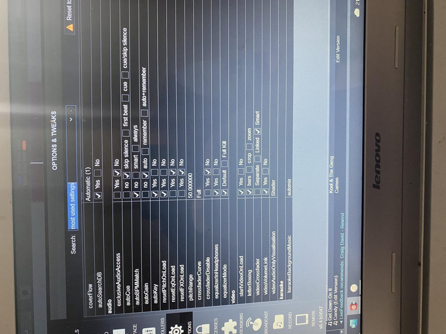

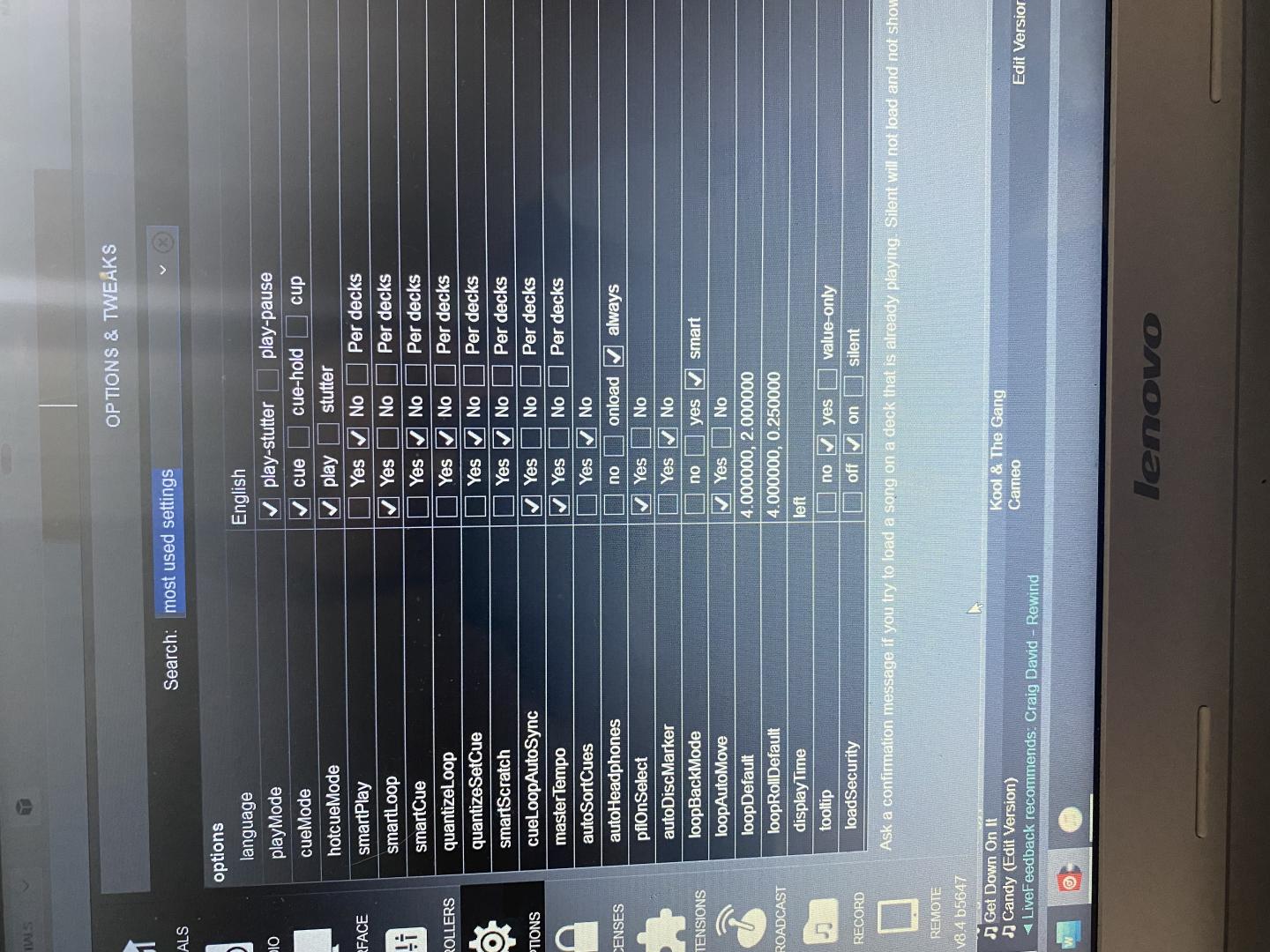

go into options select the automation tab and share a screenshot.
Posted Thu 12 Aug 21 @ 3:58 pm
Screenshot 1
Posted Thu 12 Aug 21 @ 4:10 pm
Screenshot 2
The only way I can see how to stop it is to click on the lock icon next to each deck everytime I want to sync something, but surely you shouldn’t have to do that everytime? It only takes a lapse in concentration and you have a song playing at totally the wrong BPM from an earlier track you’ve played
Posted Thu 12 Aug 21 @ 4:12 pm
Oh right beatlock, you don't really want that on at all, it's a function mainly for scratch and juggling.
It can be used for beat mixing but that was never the intended use. [I've seen it used as a 'hand holder' but it's more a hindrance when used for straight beatmixing]
to be honest I can't remember if it ever was a "saved across sessions" setting, I don't think it was, so I can't figure out why it would always be on.
turn it off on all decks and leave it off [I think scratch panel has buttons for it, but I don't know the skin you're using]
It took me a while to even recognise what you were describing in the skin [how old a skin are you using] [also why build 5647? over a year old now]
