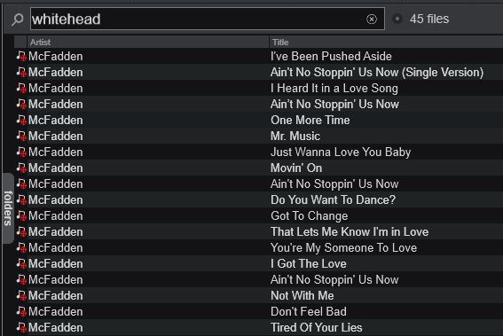

Another issue I've noticed is that when Tidal lists several people as the artist, with a comma in between, VDJ appears to be removing everything after the first comma.
Example - The Secret Garden is listed on Tidal as by Quincy Jones, Barry White, Al B Sure, James Ingram, El DeBarge. VDJ only shows it as by Quincy Jones.
Worse still, Tidal lists Sam & Dave or McFadden & Whitehead as Sam, Dave or McFadden, Whitehead but VDJ only shows Sam or McFadden.

Will check. I'm not sure about Tidal, but I remember one of the other providers also supplying multiple names, but there they were less relevant (the real name of a dj, or all the members of a group) which wouldn't be expected and clutter the artist field.
Posted Fri 17 Dec 21 @ 12:28 pm
