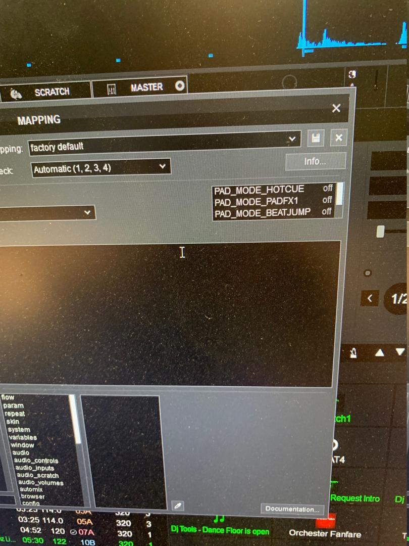

I have never made any changes to the mapping of the DDJ-1000.
I now checked and it still says "factory default"
Here is a video of the issue:
https://youtu.be/uw87veHECyE
And below an image of the factory default mapping shows when I press HOT CUE on DDJ1k
