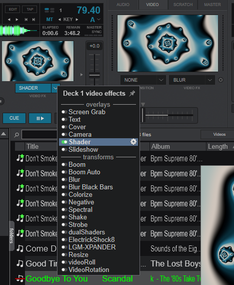

Just a problem : once downloaded it says unable to write file "...dualShaders.dll"
not a write issue, any other effect can update/install
Posted Sat 31 Jul 21 @ 3:54 pm
is it in slot while you try :), updated just fine for me.
Posted Sat 31 Jul 21 @ 3:57 pm
Of course not ;)
none of any of the visible or hidden existing 44+ slots by default select it and effects count seems coherent
But yes there is a possibility... now extra decks are no more detectable (but may not exist)
names of pads and custom buttons may need some info that force plugin to load (not in effect count)
these ones are not really easy to detect and this was the case : SHADERLISTPAD selected in one of the pages of pads of a deck

The dualShaders is really nice. I like it but, I can't seem to turn it off once I activate the switch on it. I will be playing mp4 music videos and I try to turn the dualShaders off and it won't show me my video. I have to restart my Virtual DJ in oreder to see my mp4 music videos. Does anybody know how to stop the dualShaders once it's enabled or do I have to restart my Virtual DJ in order to stop it?
Posted 3 days ago @ 5:43 am
Just turn shaders on decks off.
Posted 22 hours ago
Thank you very much for telling me that! I didn't know that. I was looking at the Master. I hit the switch there in the deck and it switched it off. I really have never paid attention to that drop down there. I appreciate you telling me about that!
The shader on deck:
Posted 15 hours ago
