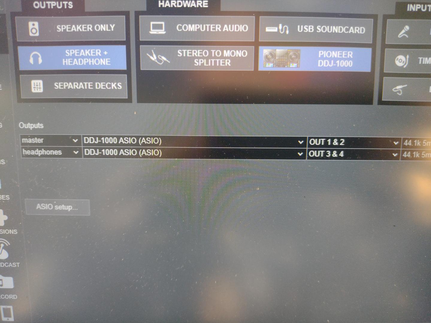

Hi djdad
finally got round to this, as far as i am aware this is the default setup for the DDJ-1000, i did remove the line input but it made no difference

Sampler vol knob , nr.18 https://www.virtualdj.com/manuals/hardware/pioneer/ddj1000/layout/mixer.html
Is it high enough ?

Hi djdad
yes, that has cracked it. it was the sampler volume (even though there is no audio, they are just video clips) but the sampler volume fades the video sample in. i had probably set this right a few years ago when i got the deck. what had thrown me here is just experiencing the issue after upgrading the software so i was looking in the wrong place for the answers !
