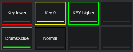

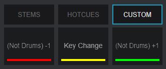

It is possible! Using the PITCH-EFFECT (and a tuning device for detecting the right numbers)
I made buttons to change key without touching the drums:
With Red Button (Key lower) You can turn the key down to 5 semitones:
with yellow button You neutralize the Key to zero:
And with the green one You push the key of the song higher step by step - also 5 semitones:
The "DrumXclue" Button preserves the drums from being shifted:
The "Normal" Button restores the normal state
With the sound I´m not so satisfied. And that's why the professionals have to get involved here. The top team of Virtual DJ can make this dream come true. As a premium feature in the next update. I keep my fingers crossed and hope as many VDJ Users as possible realize the value of this feature (before Traktor or Ableton employees do).
Greetings and best wishes!
effect_active 1 'pitch' on & effect_slider 1 72,6% ? effect_slider 1 68,7% : effect_slider 1 68,7% ? effect_slider 1 64,77% : effect_slider 1 64,77% ? effect_slider 1 60,8687% : effect_slider 1 60,8687% ? effect_slider 1 56,95% : effect_slider 1 56,95% ? effect_slider 1 50% & effect_active 1 'pitch' off : effect_slider 1 50% ? effect_slider 1 43,11645% : effect_slider 1 43,11645% ? effect_slider 1 39,22% : effect_slider 1 39,22% ? effect_slider 1 35,3% : effect_slider 1 35,3% ? effect_slider 1 31,356% : effect_slider 1 31,356% : effect_slider 1 27,46% : nothing
effect_active 1 'pitch' off & effect_slider 1 50%
effect_active 1 'pitch' on & effect_slider 1 50% ? effect_slider 56,95% : effect_slider 56,95% ? effect_slider 60,8687% : effect_slider 60,8687% ? effect_slider 64,77% : effect_slider 64,77% ? effect_slider 68,7% : effect_slider 68,7% ? effect_slider 72,6% : effect_slider 27,46% ? effect_slider 31,356% : effect_slider 31,356% ? effect_slider 35,3% : effect_slider 35,3% ? effect_slider 39,22% : effect_slider 39,22% ? effect_slider 43,11645% : effect_slider 43,11645% ? effect_slider 50% & effect_active 1 'pitch' off : nothing

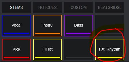

effect_stems MeloVocal on & effect_stems Bass on & effect_stems Rhythm off(Thanks Nicotux)
effect_stems off

Tested the effect on a few songs.
Actually it sounds pretty creepy, oh I could despair....
But the idea is right, I'll stick with it!
