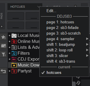

If you look at pad select drop down in the software, does the assigned pads look correct as you want?

Pad modes 1,2,3 and 8 (Shift+4) cannot be assigned to any other Pads page other than the pre-selected one, as their functionality is mostly hardware and would offer unwanted behavior.
The modes/pages that cannot be assigned dont have the arrow and the sub-menu as shown in the image..
If the other - free to assign modes - dont work as expected, please make sure you are uisng the factory default mapping, or your PAD_MODE buttons are assigned as pad_page x and all your Pads assigned to pad x
Also note, that you will need to change Pad modes from the DDJ-SB3 and not from GUI (skin). Reason is that the DDJ-SB3 doesnt offer Midi Out Notes for the PAD MODE buttons, meaning that SB3 sends to VirtualDJ the Pads mode, but not vice versa.
So you have 4 modes to customize with your preferred VirtualDJ Pad pages (along with the 4 pre-set) and do not use the skin to change/select pages.
