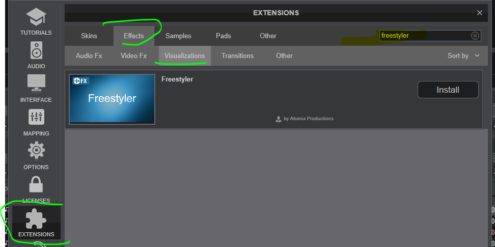

No longer available, and not needed...
You can add Freestyler from the Extensions inside the software
Or, alternatively for more "advanced/complex" use, you can also look here:
https://www.virtualdj.com/forums/218737/VirtualDJ_Plugins/The_Advanced_Freestyler_integration_thread.html?page=1
