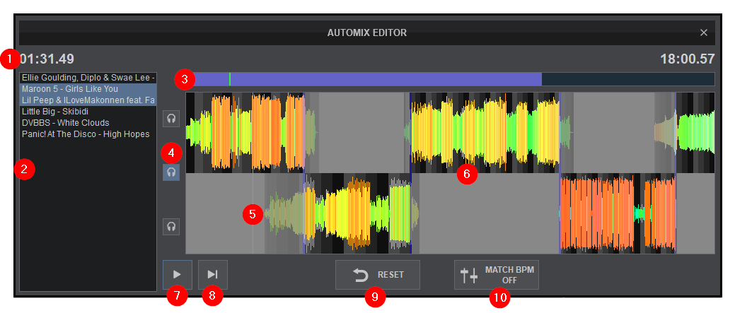

Or if you want to make a "custom" automix you could just use the Automix Editor and drag and drop things into place how you want it
https://virtualdj.com/manuals/virtualdj/editors/automixeditor.html
