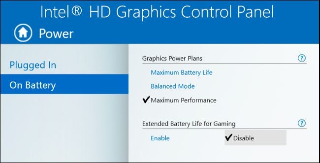

Try this, just to test if its something odd with the graphic card..
1) Set Intel Graphic to full performance (full 3d)
2) if that didnt fix it, try set videoUseDXVA to no in VirtualDJ settings
