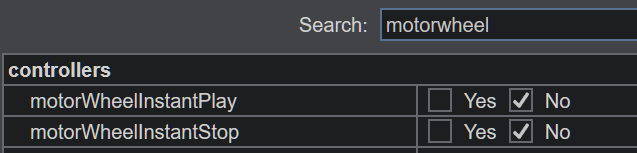

1st and formost thank you for adding the support for the rain one i was tired of using the software that was provided with it. okay now that i have been using that other software i notice that now that im over to vdj there are a few things that are missing . the instant double i know you can map that but i was thinking since it came installed on the other program i though it was gonna be just like that in vdj although in the other program all 6 fx are for both decks i notice on here it's 6 fx for each deck thats a good thing now the last problem is the turn table stop it sounds horrible compare to the other software even the control knob for the speed of turn table is off everything else is good i waited forever so i could use vdj over the other software. so in a nutshell the instant double and the stop speed of the plater the two main culprits

Instant double looks to be on the Shift + Load (press) on deck,
https://www.virtualdj.com/manuals/hardware/rane/one/layout/decks.html
Not sure about the turntable stop, but since its a motor, its probably as the motor is
Shift + Slip button to turn motor on / off
Can "emulate" it on the play button, but not sure how that will be since it has motor.
In settings, set rampStopTime to 0.5 for example for half a second (might be better to do it "old school" with the motor though)
Posted Thu 25 Feb 21 @ 9:18 pm

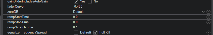

Ok, I figured this out, set the ramp stop time to "0" otherwise what happens is that when you hit stop, VDJ applies the software stop time first and that conflicts with the actual hardware stop time, hence the weird sound. lol This drove me crazy for months now!

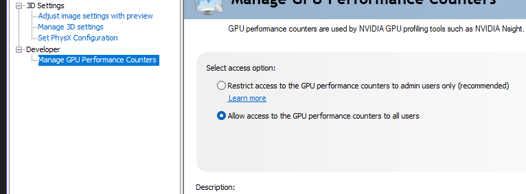

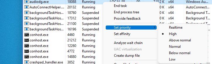

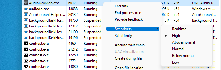

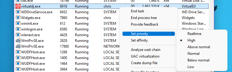

djnikkofb wrote :
From what I've found using the Rane One to remove all AUDIO issues.
1) Before you even start Virtual DJ (every time) RUN the Rane One Program & Calibrate Fader.
2) Launch or Run Virtual DJ
3) Press ctrl + alt + del, and enter task manager
4) click DETAILS tab
5) Locate virtualdj, Right click, set priority HIGH
6) LOCATE audiodg, right click, set priority HIGH
7) LOCATE audioDevMon, right click, set priority HIGH
+ DO THIS EVERY TIME BEFORE U DJ A SET.
OPTIONAL
1) Open NVIDIA control Panel > Developer > Manage GPU Performance Counters
2) SET "Allow access to GPU for all users" (This is KEY for perfect 60fps+ skin Resolution)
4) VDJ settings for headroom or ZeroDB = Default or none
3) Upgrade to Windows 11, everything runs so much smoother.
I will update more settings soon
OPTIONAL
Posted Thu 05 May 22 @ 2:04 pm
