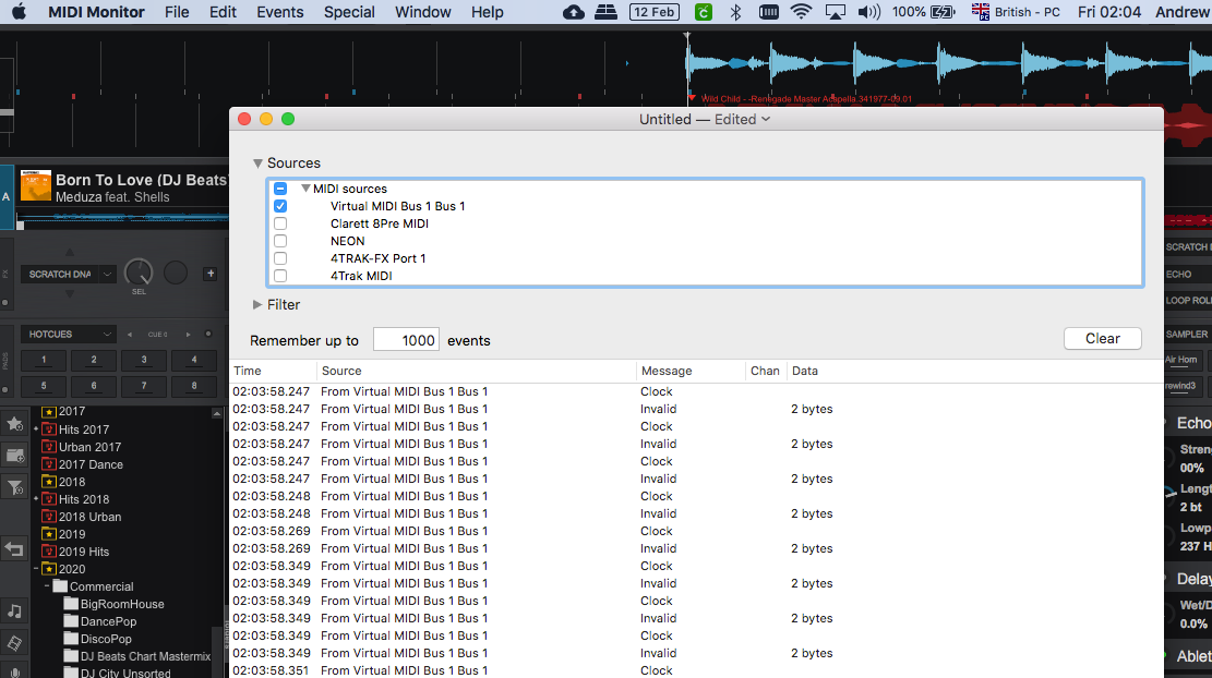

As you can see in the screenshot above, I used MIDI Monitor to see if the clock was being produced and sent to the MIDI bus and it looks like it is, but each clock signal appears to be followed by 2 bytes of invalid data. I did also look at the midi clock produced by Ableton and in MIDI Monitor it doesn't show any invalid data.

F8 (Midi Clock) is indeed sent correctly.
I can also see some 00 00 s sent after that, but not sure if it matters. If the other app needs to listen to MIDI Clock inputs, then the 00s should be ignored.

Thanks for the reply, no I couldn’t find another way to easily to send the virtual DJ clock to any other bus than the IAC, and I couldn’t see a way of looking what was inside the ‘invalid’ bytes reported by midi monitor.
Doing the same thing with Ableton doesn’t report any ‘invalid’ data in midi monitor and that clock signal does get received by the other program successfully, so that’s what lead me to think perhaps this was a bug. Do you think perhaps this is deliberate so if I want this to work I would need to find a work around?
