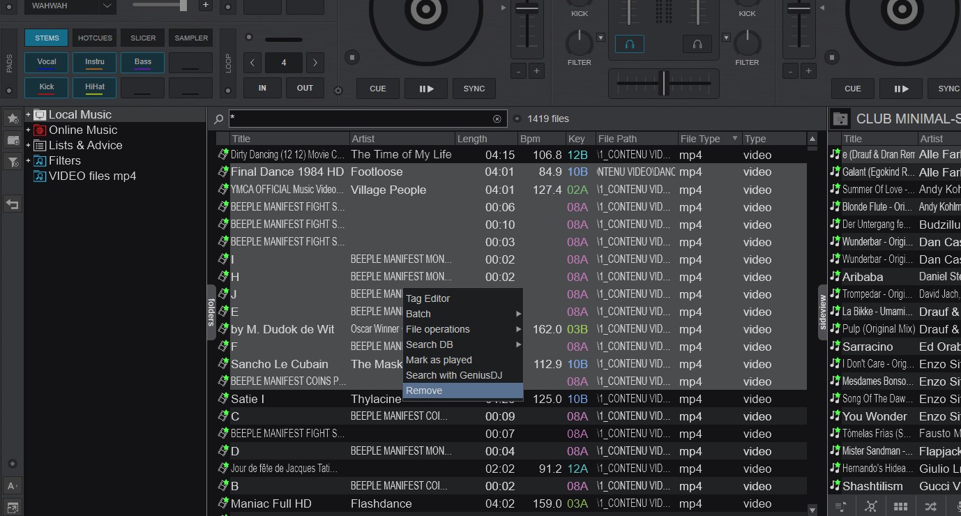

So I'm using "remove", after typing "*" in the search field (see screenshot), but it won't remove the tracks from the db.. (if i close VDJ and reopen again, all removed mp4 tracks are there again)
Am missing something so obvious...? Can you help me again please? :)

First, thank you for your fast reply!
Ok I did what you said and indeed I can see the files again.. but, how do I remove them now..? I tried but I couldn't :/
If I do "delete", it gets deleted from my hard drive, hum. And if I do "remove from search db", then it remains in the db (as said earlier)..
Thankss
Posted Thu 28 Jan 21 @ 11:58 am

There is indeed no way to remove files that still exist from the database, since there's not much reason to do so.
Perhaps rekordcloud should be fixed then to correctly read the hide from search db flag.
Posted Thu 28 Jan 21 @ 12:32 pm
