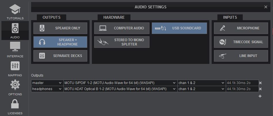

What's your audio config? The crossfader won't work if you're using an external mixer config - each deck goes directly out. The on screen mixer is bypassed.
Posted Fri 18 Dec 20 @ 8:59 pm
I use a USB soundcard so I guess this classifies as an 'external mixer'. So this must be the issue. Any solution/workaround for this?

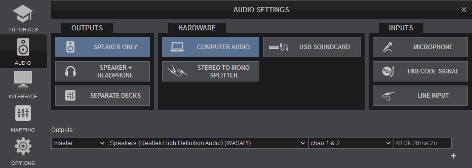

I tried to simplify the output by outputing the Master to the speaker of my laptop only. Still the same problem.
And I checked what an 'external mixer' is (it's analog and deck outputs are sent out directly): that's not my setup.

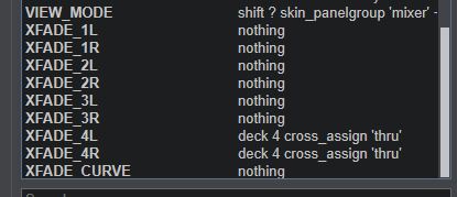

Ok now I understand and I was able to solve the problem.
My controller is a Numark NS6. It has audio capabilities but I don''t use them (I use my computer audio card). It has crossfader controls and these were causing the issue.
I don't want to use the crossfader controls on the NS6 (except for the crossfader itself) so I have now disabled them like so:
and I added the following code to the ONINIT in the controller config:
& deck 1 cross_assign 'left' & deck 2 cross_assign 'right' & deck 3 cross_assign 'left' & repeat_start "delay" 2000ms 1 & deck 4 cross_assign 'thru'
so ONINIT is now:
fake_hp on & fake_master on & deck all effect_3slots_layout off & deck 1 cross_assign 'left' & deck 2 cross_assign 'right' & deck 3 cross_assign 'left' & repeat_start "delay" 2000ms 1 & deck 4 cross_assign 'thru'
Note the repeat_start that I had to add, otherwise the deck 4 crossfader was not disabled (a race condition somewhere I guess, not sure why). I use deck 4 for the sampler.
