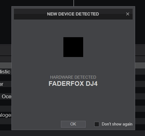

Ahaa, okay. Now I get it. In the controller definition really just identifies the connected hardware and names all the controls. Then these names will be mapped to functions.
Thanks for the hexa hint in the vid and pid, the hardware was now detected. The named controllers showed up but I can't map them, or at least they do not seem to arrive properly.
