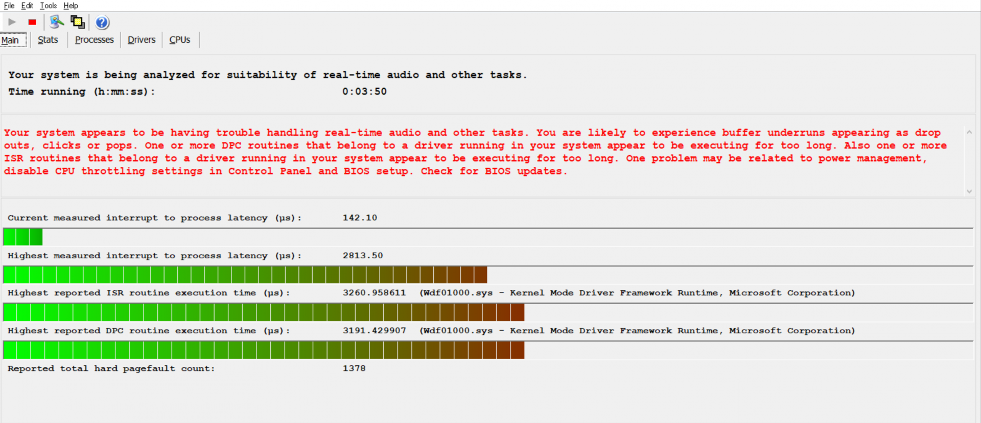

Hi Rune. Thanks again for your help. I suspect the problem may be beyond my tech capabilities and the ambit of this forum. The latency test brought up various problems.
Other reports show ISRs with highest execution times: ACPI driver for NT, and highest DPC routine execution time: TCP/IP
I have looked on HP forums and there are some reports of latency problems but I cannot find any solution. Seems extraordinary that a $2000 machine can't run Virtual DJ out of the box.

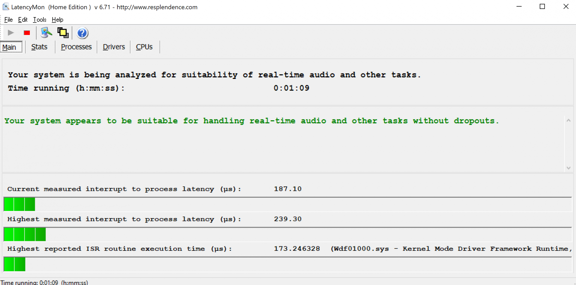

HP and Dell machines are notorious for bad drivers causing latency.
Here's my Lenovo C940 while running VDJ and sending HD video to external monitors and the MCX8000 as controller. Nothing shut down or disabled.
You can try finding out which drivers are the issue but another machine may be the way forward.
