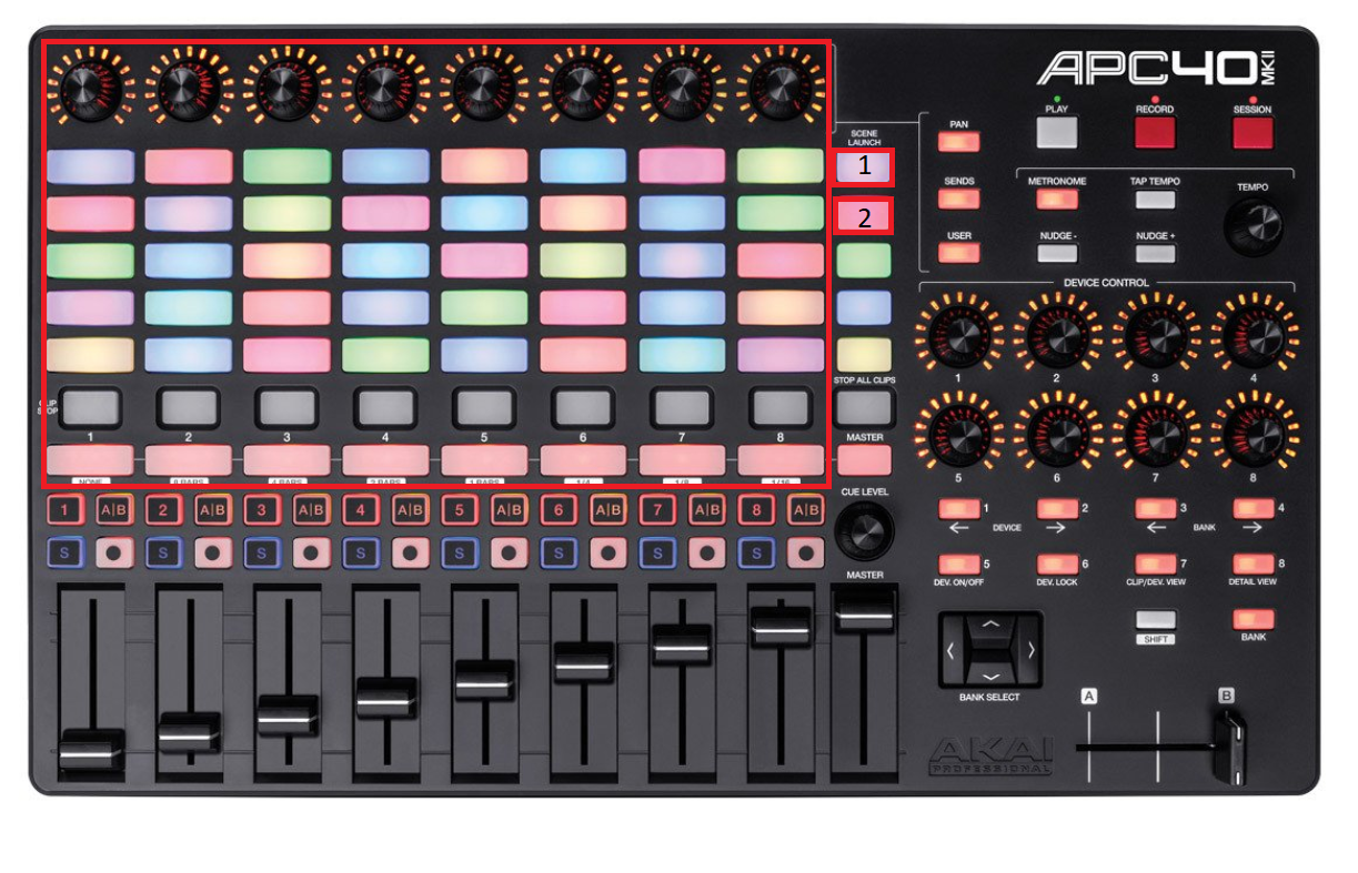

Hello everybody,
I have a problem with APC MK2 mapping.
I'd like to use the top row of knobs and buttons below them to control the effects depending on the scene launch button being triggered
So that when the first scene launch button from the top (1) is active, you can assign effects, and after activating button 2, you can assign subsequent effects to the same buttons and knobs.
I think it is possible because the original mapping uses such a function but I don't know how to do it?

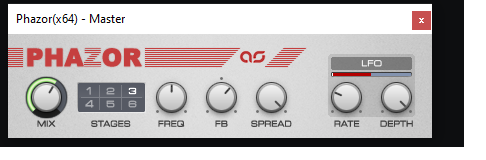

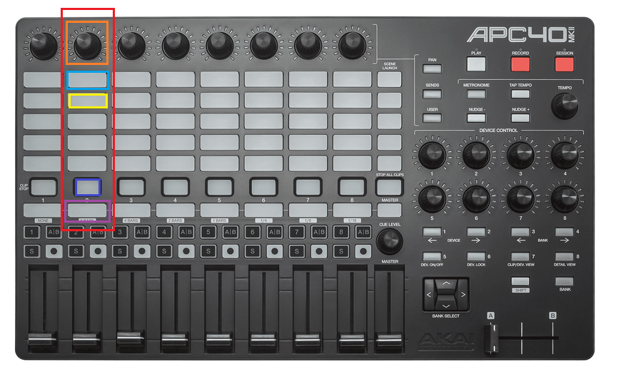

"Tonight, I will restore the APC 40 midi factory settings and try to use the pre-programmed banks." - unfortunately it did not work as described above - it looks like more code is needed ;)
@Rune (dj-in-norway)
for example, the effect I mentioned above FX PHAZOR
works on slot 2 RED FRAME (FX master effect)
KNOB orange frame - the knob is used to control the mix (intensity of FX)
CODE: deck master effect_slider "PHAZOR(X64)" 1
Button - darkblue frame - shows FX panel
CODE: deck master effect_show_gui "PHAZOR(X64)"
Button - violet frame - activate FX
CODE: deck master effect "PHAZOR(X64)" active
then blue and yellow frame button are used to induce the desired knob position in effect (we can program 5 presets because we have still 3 more buttons below)
CODE:deck master effect_slider "PHAZOR(X64)" 2 30% & effect_slider "PHAZOR(X64)" 3 50% & effect_slider "PHAZOR(X64)" 4 65% & effect_slider "PHAZOR(X64)" 6 25% & effect_slider "PHAZOR(X64)" 7 100%
or
deck master effect_slider "PHAZOR(X64)" 2 30% & effect_slider "PHAZOR(X64)" 3 50% & effect_slider "PHAZOR(X64)" 4 85% & effect_slider "PHAZOR(X64)" 6 25% & effect_slider "PHAZOR(X64)" 7 100%
Obviously this is just a small example but this way you can make an intuitive FX tool.

scene launch buttons sets
var '$apc_rowsel' VALUE
between 0 - 5, when the device is initialised or a scene button is double pressed the vaule is ZERO
so as per your orange example
var '$apc_rowsel' 0 ? deck master effect_slider "PHAZOR(X64)" 1 : var '$apc_rowsel' 1 ? SOME OTHER USE : var '$apc_rowsel' 2 ? ANOTHER USE : etc, etc

Yes! It works!*
* I changed var '$apc_rowsel' 1 to var '$apc_rowsel' 1 ? set '$apc_rowsel' 0 : set '$apc_rowsel' 1
THX @locodog. :)
THX @locodog. :)
