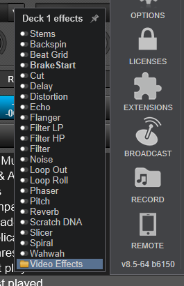

Explain Ducking feature, I know what ducking echo is from the 909 but I cant seem to find it. Also would it work on a hybrid mixer where the lines and faders do not control the software.
Posted Mon 02 Nov 20 @ 3:11 am
Klaus has put up a short quick demo on YouTube;
https://www.youtube.com/watch?v=nW6rdTn9oTE
Posted Mon 02 Nov 20 @ 3:31 am
Its not there in my effects list.
Posted Mon 02 Nov 20 @ 4:32 am
Yes, the Ducking Echo is missing. Where is it?
Posted Mon 02 Nov 20 @ 5:01 am
You have to install it from Extensions in config
Posted Mon 02 Nov 20 @ 6:11 am
