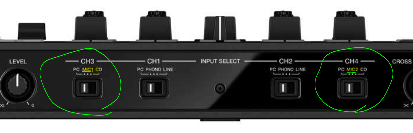

Do I will just use normal mic connection on back and set up as in picture ..I have done this but I will try and take time tom to go through it thoroughly thank you

Ok I've set up exactly as in pics on manual page and set front switches to pc and I'm still getting nothing coming from mic am I missing a setting ....when set up like the way you show in software no mic on master section to select for volume ect....take it for this to work I will need external soundcard
Posted Thu 05 Nov 20 @ 7:27 pm

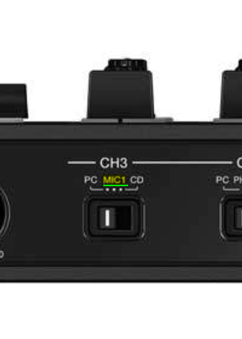

The switches need to be on mic
Posted Sat 07 Nov 20 @ 2:32 am
Need to set the switches to mic yes, when you are using the mic ;-)
Posted Sat 07 Nov 20 @ 10:00 am
