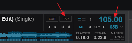

I've just been editing a track that had a variable bpm, so that I can play a drum sample behind it. Now I need to press Tap to level up the beat on the wave but it just takes me straight to the bpm editor. Before editing I could correct the beat by pressing tap? Bound to be something obvious but im missing it at the moment. Thanks.

Which skin are you using ? In the default Pro skin , clicking on BPM value, opens a small side panel with a TAP button that doesnt open Editor and does whatr you want.
Or is this not working like that only with tracks that have multiple BPM ?
EDIT.. Ah yes, the TAP button indeed opens BPM Editor when has multiple BPM. But isnt that reasonable to do ? I mean you have to decide which one of the variable BPM area (Anchors) you need to set as "first Beat".

I am having the same problem (and this has changed, was able to set first beat hitting TAP), also the CBG adjust buttons don´t do anything.
I am working on a track that has one bar inserted in the middle of the phase and have set a new anchor on the new 1, but the phase just advanced the three necessary beats instead of seting this the 1/1. So, instead of 22 incorretly it now jumps to 25, but it should be 32/1 respectively

I have learned to use the TAP to align the first beat before Re-analyzing for Variable Beat, since TAP button is easier to use, then using the BPM EDITOR after the a track has some Variable Beat segments set.
Yes re-analyzing will remove all your Work you did in the BPM Editor.
