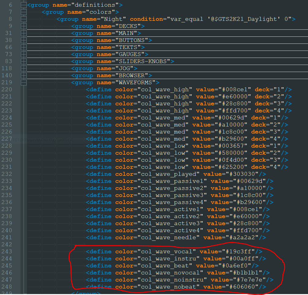

Ive changed the colors of the stem colors in the moving waveform, Im just making sure, when you release an upgrade the colors will revert to your stock colors?

The colors of the stem waveforms would be possible to carry over only if they were included in VirtualDJ options.
Other than that, a skin is able to provide as many color schemes as it's creator decides. Not any user defined (for that the user will have to re-edit the skin)
However with color definitions on skin and with their placement near the beginning of the XML in my skins case, it should be a trivial job to do.
Unzip, edit the xml (change 3 lines of code), save, rezip, done!
What would those 3 line be?

What lines of code have you changed ? :P
On latest version it should be around line 243
Posted Fri 18 Feb 22 @ 9:36 pm
Yes those are the lines i changed.
Ok, I was going by heart. It's 6 lines of code instead of 3 :P
Do you mind to share the colors you used ?
If I find them attractive enough I may introduce them as a built-in color scheme.
