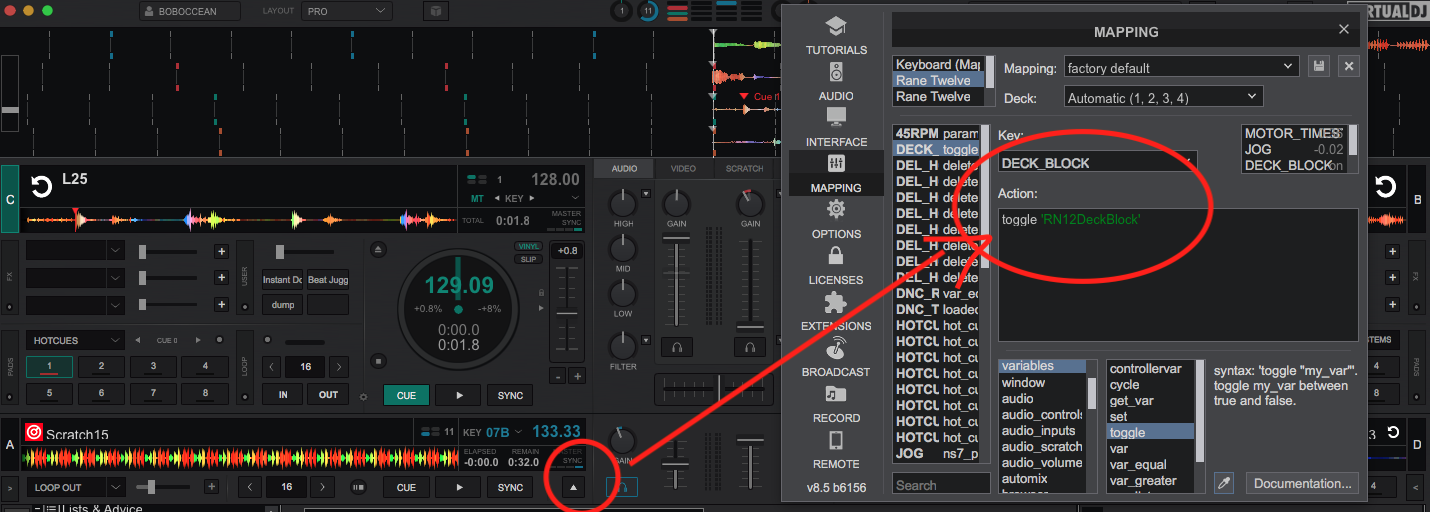

Hi, i configurate with the rane 72 with deck 3 & 4 assigned to Channel 5&6 (same as the Sampler).
i can switch fluently from 1 to 3 or from 2 to 4.
the only thing who is missing is to switch the deck 3 to 1 on VDJ interface to make automaticly the 72 buttons switch.
For now just select the button next to sync (arrow to top) and the mixer will switch.
if the deck select button could do it at the same time it could be perfect. 4 deck with a 2 channel +1 mixer
Linked those two fuctions together as in the picture will be good

@techtich thanks for your help. i tried your recommedation, swap_button work perfectly with the Rane 72 not The twelve. I used MKI so MIDI signal not DVS or Timecode. I had to select the correct deck to controll the platter. As @PhanomDeejay said is cleraly FIRMWARE limitations of RANE. I Mapped a Keybord button it's Ok but not possible to do the same with deck select. Use thenm separetly not as a bloc to toggle is lacking. with SERATO only deck 1 and 2 are highlited when plugged on Rane Mixer. really expect In Music will do as for DENON full integration of VDJ on RANE Hardware
