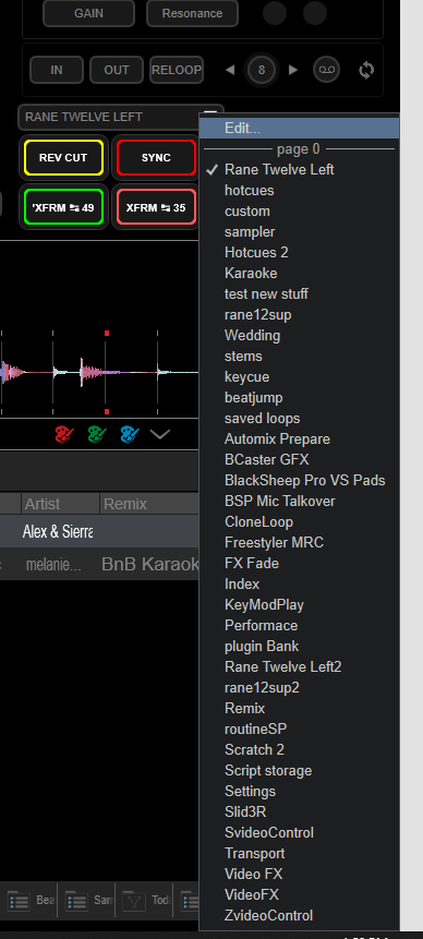

"Since the recent update that reordered the setup page and renamed the controllers section to "mappings", I no longer see the option to check independent pad page per controller. Now all my midi devices switch pages when any one of them does. Help?

Thanks Dan. I must have encountered a bug somewhere in the process. The manual says that all midi controllers should appear in the pads menu, but all I get is "Page 0" (see SS)

What controller is it?

You may have to trigger a page change on the controller for it to show.

Initially I saw the error with my Rane Twelves, Traktor F!, and DDJ-XP1 attached. But I have tried every controller I own ddj-sb2/and sb3 ddj1000, reloop neon, etc.
I did try to trigger pad changes from all the different controllers and still get no controller showing in the pads list

Of course you have to use default skin (or an updated custom skin) to get the full size menu...
Older (not updated) skins will allow you to change only "current" pad page
