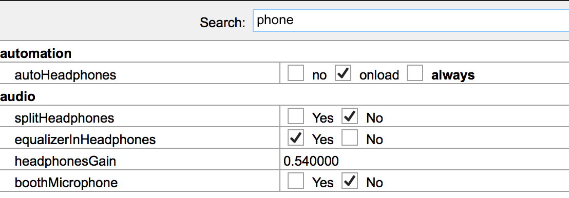

Auto onload on headphones don’t work
Posted Fri 10 Jul 20 @ 5:35 pm
still Auto onload on headphones don’t work after 6011

DDJ-sx2 and my Dj2go 2 I have not tried it on my RMX’s 1 & 2
Posted Sun 12 Jul 20 @ 2:36 am
You also need pflOnSelect to Yes
And one other note: For auto-Headphones/Pfl automation to work (except from the 2 settings you need to have enabled), the status of SELECT and PFL need to match. If for example you manually enabled both PFL buttons, then the automation will start working again if you manually match the status of Select and Pfl.

ok that was it PFL sorry I just seen your post.....

Do The autoHeadphone work on DDj-SZ-2 I have autoheadphone to ( Onload ) & PFL to ( Yes ) the songs are loading but the cue/headphone is not working.
Posted Fri 24 Sep 21 @ 1:00 am
No, the leds of the PFL buttons on DDJ-SZ2 cannot be controlled by MIDI (VirtualDJ) and the Headphones routing is done by Hardware, so autoheadphones wont work
