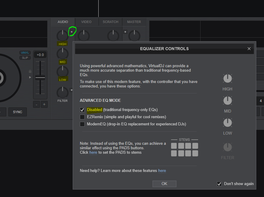

ZenergyMusic wrote :
So i updated to the new version, and when i use the eq to cut the low on a track, it just sounds like its filtering it rather than cutting the eq, is it possible to go back to the old sound of the 2020 version?
Just click the EQ mode drop down and select what EQ knobs should act as.
If they are set to be controlling stems, you might feel like its "filtering" and not sound exactly same as traditional EQs (since its not same thing happening).
If you prefer traditional frequencies EQs you can set the stems on EQs to disabled, but still be able to use the stems on pads, audio fx, and vocal isolation on color fx.
