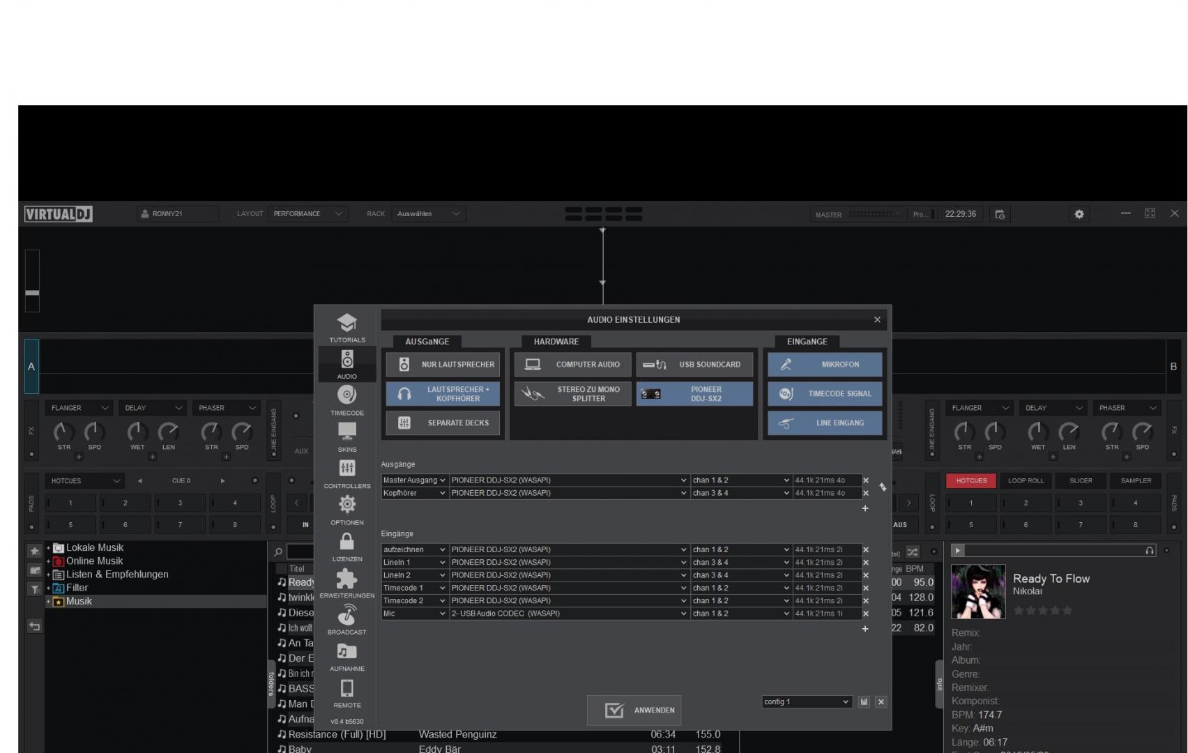

Hello i have my Turntable on ch1 and phono the timecode Play pause an so works, but i only hear the timcode signal, not the mp3 soundfile?

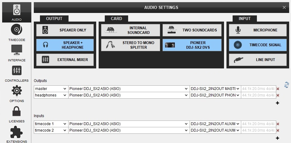

Why are you using WASAPI? You should be using the Pioneer ASIO driver.
Why do you have two timecode inputs using the same channels? The same channels are also used by the 'record' option.
Also you may need to change the SX2 audio I/O config with the Pioneer utility.

You added BOTH line in and timecode at the same channels (inputs). And much more
Fix your sound settings, and all should be good ;-)
