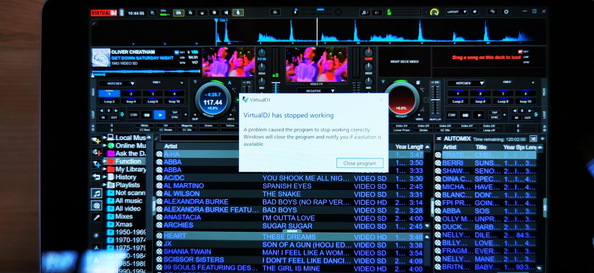

Build 5619
Load a batch of videos in Automix, select mix now, it stutters for a couple of seconds then crashes
Also happens on 5630 but VDJ restarts so maybe a crash log sent? I noticed too it plays the same file twice in a row when using mix now.
Posted Wed 08 Apr 20 @ 9:47 am
